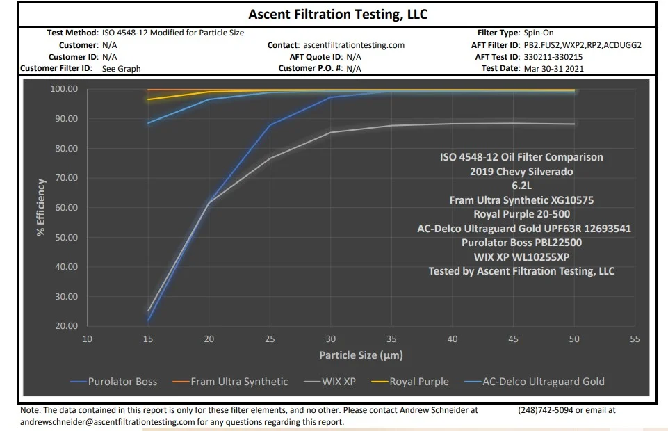

I no longer buy Fram oil filters.
NAPA Gold (~$9):
I mostly try to shop local.
Your choice. Someone needs to buy inferior products. Napa/WIX is not anymore best.
It is true, it used to be some 20 years ago
Here is the latest test results i could find. Probably there are more updated, but i could not find them.
Wix XP, which is Napa Gold i think, is a very mediocre filter among latest. Fram, Purolator and RP currently are the top choices where Fram XG Ultra synthetic is the best just after the latest Fram Synthetic Endurance which is not part of this test
