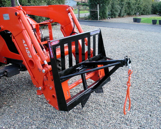

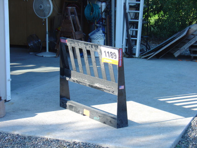

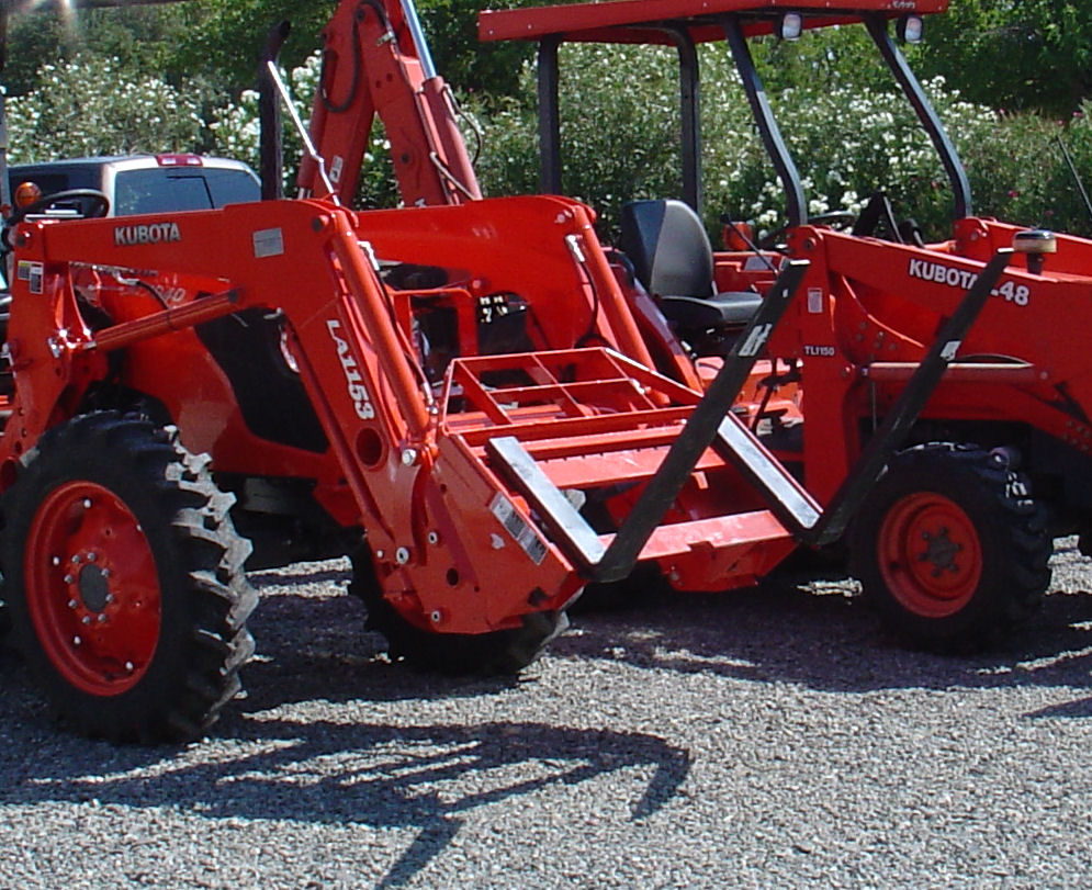

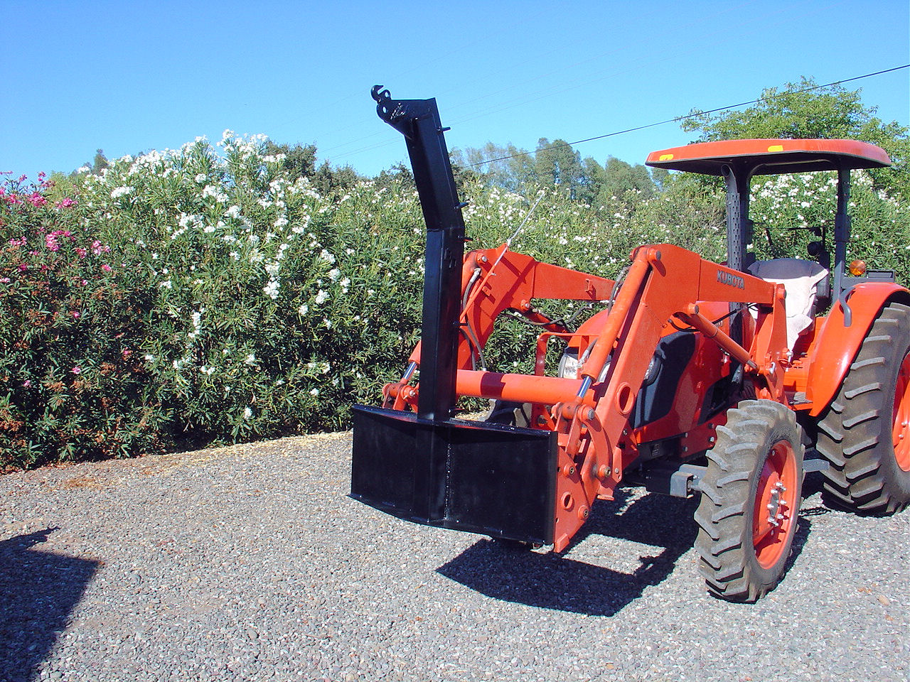

Mine are: forks, fork frame with weights, boom, flat plates for straightening wood piles and adding to an implement to make it usable on the front end, log carrier. Here are some that I photographed (click for larger image):

The weight carrier for the front and the log carrier were homemade with forklift frames bought at Ritchie Bros. Auction.
The log grapple on the front of the carrier is for small trees. I also have a momma size and a papa size grapple. It makes the tractor look like a narwhal but it sure make bucking into firewood easy. Just set the FEL so the log is at waist level and zip, zip, zip....
The bigger trees have to be cut into 20' lengths and a substantial counterweight is needed on the back:
