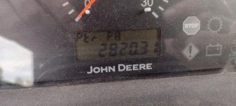

We have a 2011 John Deere 5065M 5 cyl. turbo cab model and it randomly stops moving. The red ring gear illuminates on the dash and it will not move until you put it in Park and neutralize the Power Reverser, turn off the engine and restart. It's very random and it has been in the local JD dealership shop twice. It's only been back a few weeks and it's doing it again. The Clutch Position Sensor, basically a potentiometer, has been changed twice and this last time they also changed the Neutral Switch on top of the transmission. Dealer says it's not throwing error codes and they can't get it to duplicate it of course. It’s a 16F/16R transmission. Tractor has about 2400 hours on it. It's already done it 6 times since coming back from the shop this last time. Son was backing up to hook up to a drag harrow this afternoon and it red ringed on him twice.

I am really surprised it doesn't store a code when it stops and red light comes on. Does it do it while moving or only after a direction or gear change? Always forward or sometimes reverse as well? The more detail you can give as to when and how it happens can help. Does it happen on level ground, uphill, downhill, on side of hill? Does it ever happen when first started or only after being driven a while? As a dealer tech with many years experience, I can say the intermittent issues are the worst to diagnose, especially when it doesn't leave a clue behind with a code. When that happens, it is absolute guesswork if nothing is visually obvious. There is a bulletin/solution that talks about the neutral switch on top of the transmission that can cause this issue. Some 5M's had 2 different switches on top. Do you know which one they changed? The AM117780 is the one mentioned in the solution. Many things can cause this issue. Several different switches, sensors, solenoids, transmission controller, and many wires. It may be beneficial for dealer to come to you and plug computer in to monitor everything while you operate it if he cant duplicate problem.

"I am really surprised it doesn't store a code when it stops and red light comes on."
A mobile independent equipment tech was here last week on a overheating Kubota issue so while he was here we had him take a look at it. He actually pulled up two codes on the little display but could not replicate the issue at hand. I believe he said he thinks it's either another bad clutch position sensor or the forward/reverse solenoid. Amazing that he was able to pull those codes yet JD has been telling us all along that it was not throwing codes. Pictures below.

Here's the two codes he pulled up:

The Tech was here this morning at 8am. It didn't take him long to find an issue with a little micro switch on a wiring harness about 2 feet long. He said the switch is working intermittently and telling the computer that the clutch was in and out at the same time each time the switch wasn't working properly. He ordered a new wiring harness and said it be here Tuesday. He wasn't there but an hour and found out more than the last Tech that had at the dealership for 2 weeks. We just hope it fixes it.
Part they're replacing:
AL158036: Clutch Control Wiring Harness
