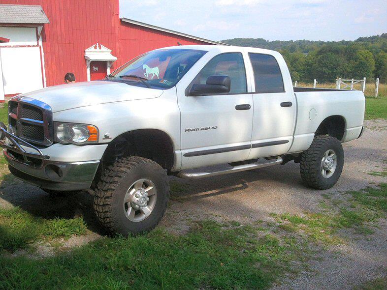

I bought my Ram 2500 diesel 4x4 quad cab new in 2004 (it's the 2004.5 model with the then new 24-valve 5.9L "600" motor - 600 lb-ft torque). It's got 147K on it now and has had a 6" lift with 35" Khumo mud tires. It's an auto tranny.
When I first bought it it got about 16 MPG, but at about 20,000 miles the mileage just started getting better and better. I got 23-24 MPG on the highway, and it only dropped to about 21-22MPG after the lift. Still gets that same mileage today.
I pulled a tandem axle trailer with about 6500 pounds in it from Texas to Pennsylvania and got 19MPG average for the trip.
Stock tranny has held up, even with the larger tires (and I didn't regear the diffs). They're 3.73. Lost a little acceleration, but not significant.
I love this truck, best truck I've ever owned, however....
In 2003 Dodge stopped using Dana axles and went to AAM. This is the worst part of the truck. The ball joints absolutely suck. The full weight of the front rides on the lower two ball joints. The uppers aren't really ball joints and are more like king pins. They last about 40-50K miles and are shot. I rebuilt my whole front end when I did the lift. I opted for the $600 Dyna-Steer joints which are larger and much heavier duty than stock (Carli also makes excellent heavy duty joints, but theirs are $800). I also replaced the tie-rod ends, steering box, track bar and steering shaft (another part that wears out quickly). I added a steering brace as well and dual steering dampers. Front end is now much, much better.
The only other area that sucks are the wheel bearings. You can't replace just the bearings, you have to replace the entire hub unit at $350+ each. Haven't had to do that yet though, but probably soon.
Everything else about the truck has been great. The ride is a little more harsh with the lift and tires, as expected, but outside that it's taken everything I've thrown at it and then some without a wimper.
I know the new 6.7L Cummins has had issues with the regen cycle of the exhaust (all that new pollution crap they keep adding), and the mileage is down on them, but haven't heard much else. I hate the new body style. Too square/boxy looking and reminds me too much of a Ford.
Here she is:

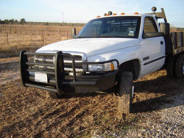

My daily driver is a '01 Dodge 1-ton dually with a 9' flatbed. Like someone else said, I bought a Cummins engine with a Dodge wrapped around it. But I do like the truck. The Cummins engine is the best for hauling, IMO.
Being a Dodge truck owner, I highly recommend you join the Cummins forum, lots of really good folks over there. :thumbsup:
