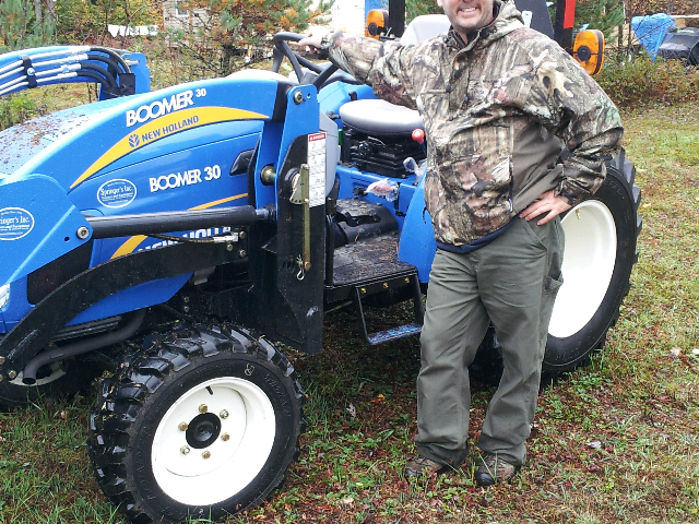

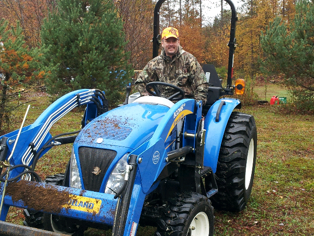

Already putting her to good use filling a trench.
She sure is a beauty.. and you look mighty happy! Please remember to always move with the bucket low (top of the bucket below the top of the hood).. That will keep that dirt off of the hood, and the shiny side of the tractor up:thumbsup: Good luck and congratulations on your beautiful new tractor!
