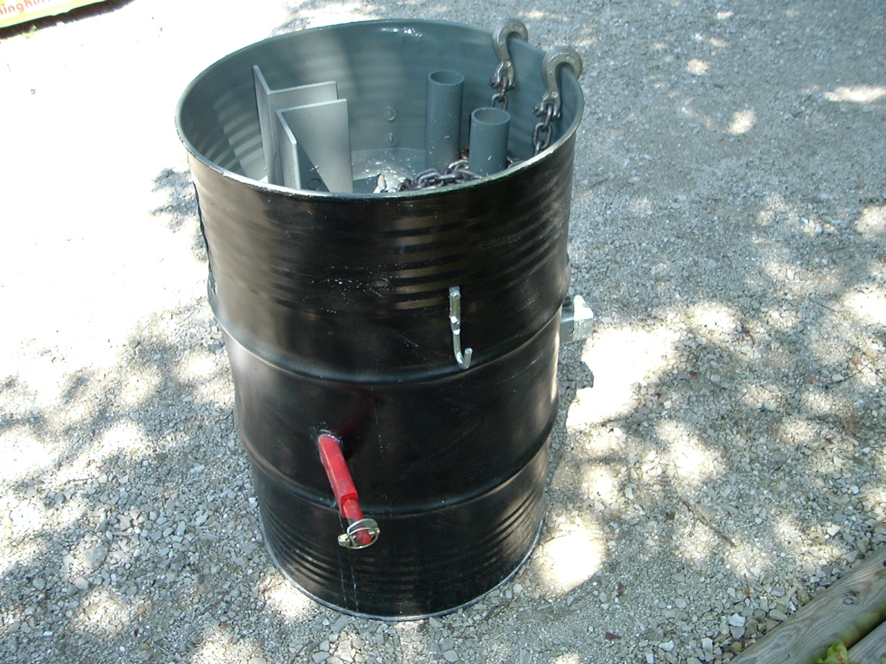

Thanks, Max, Vince, Bullit, James.. Kubota's a great brand but will be over my price poor man's price point. Mahindra, I'll wait to see their quote. Seems it's come full circle, but at least I've learned a ton from you guys, and done my due diligence. I've also learned, there's probably not a "bad choice" but some are better than others, especially depending on budget and use. BTW James, whats "Home-Brew 750 lbs ballast box"? Is that like 750lbs of brew at home in a box? :cool2:
Doc
   / 2012 NH Boomer 30 HST or Kioti CK30 HST? Value? #42
Doc
Yep!.. ha ha..no it just means I "brewed up" my own ballast box. made it myself.
