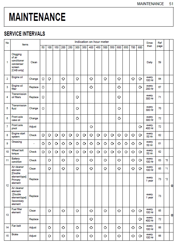

Here's the service maintenance schedule for my B3030. Should be the same for the 2650.
400 hours is considered a major one. 300 is another major for oil/filter changes in the HST and oil in the axle. I'd see if there is documentation showing what maintenance has been done on it.
