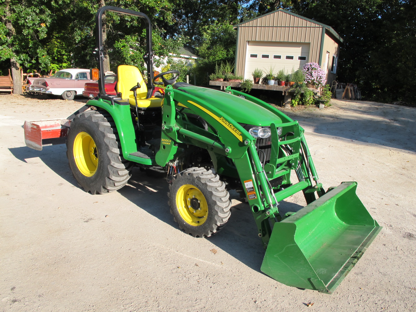

Time has passed since your comments regarding an 85" snow bucket. I thought an 84" Horst Materials Handling Bucket would be a huge improvement over the standard 60" bucket. Perhaps with chains the results would be different, however, I find in "float" position and with a bit of snow, it is very difficult to steer with the 84" bucket. My bucket has a capacity of (I think) 31 cu ft and it very easy to load the bucket to the extent the FEL either cannot handle the load or if slightly uneven, put the tractor on three wheels. I rarely use the 84" bucket anymore.
I have found the combination of 60" rear Blower and standard 60" front bucket to be far superior for the majority of snow jobs.

   / 2014 John Deere 3320 #15
I can see by this picture that there is something drastically wrong with your shop. There's this grey thing with a bunch of plants on it right in front of the door!! How can you use the shop? This is a catastrophe. :) All kidding aside congratulations on your new tractor.
