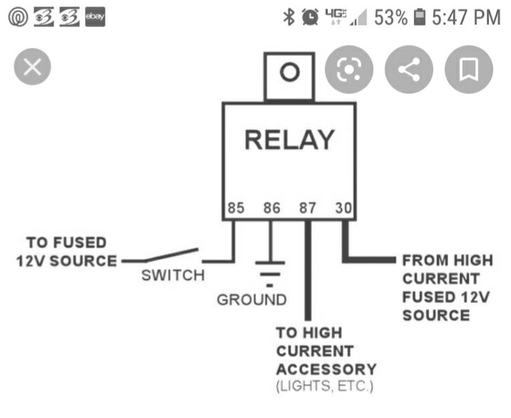

Look at this diagram and verify your wiring to the numbers. This should help. 20200828_174830.jpeg

Look at this diagram and verify your wiring to the numbers. This should help. View attachment 667794
The pictogram you just posted is different than the directions form a few years ago. I followed the steps below....
Can someone explain this diagram to me in lay mans terms?
I have the NAPA solenoid installed & grounded. I am up to an embarrassing 10 clicks before she starts.

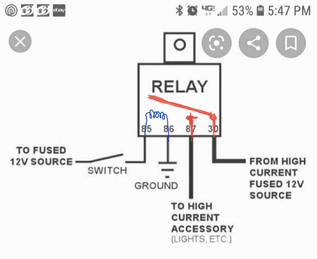

There appears to be a coil between 85 and 86. When electrical current flows through the coil it becomes magnetized which pulls in the red arm. This action connects 30 to 87. Pardon the crude sketch and hope this helps.tapatalk_1602641499081-1.jpeg

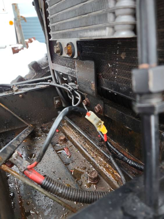

Had intermittent start on our 5010hst and it was the small power supply lead from battery - the crimp on the spade terminal in the connector had corroded so that wire would occasionally make / break connection... Temp fix for now till I get proper terminal of another single wire blockIMG_20201214_144435634.jpg
