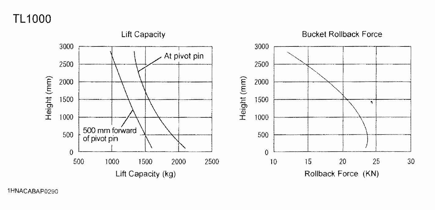

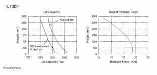

That 1691lbs number for the LA1065 is for 500mm forward of the lift pin at max height where the loader is the weakest. Lift capacity at 1500mm and 500mm in front of pins is 2319lbs so make sure you are comparing apples to apples.
Here are the tables/graphs from my LA1065 manual.
L39 speecs for comparision. I suggest larger L1065 loader. Get the 2014 if it has larger loader.
