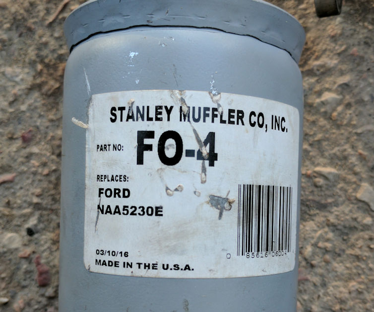

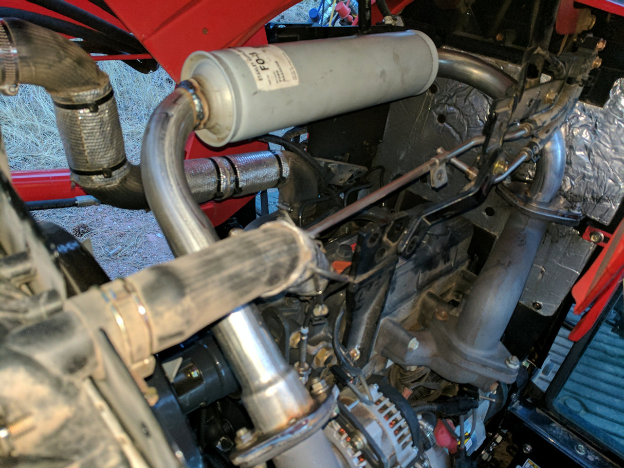

I bought a muffler at Tractor Supply and took the new mufler and the DPF to Bud's Muffler in Colorado Springs. The bend on the inlet to the DPF is so tight that he had to send the tubing out to get it mandrel bent and he also had to have the flange plates fabricated because they apparently aren't a standard size. The muffler cost about $30 and the shop work was $156; so my DPF delete kit for the 2015 Branson 3520H was under $200.
I dropped it off at Bud's just before new year's eve and they called today to tell me that it's ready. I told them no rush, so it took about ten days to get the work done.
My wife is picking up the muffler this afternoon and I will install it after work and take some pictures. I'll take some video too so you can hear the way it sounds with a muffler instead of DPF.

Did you pipe it up or have it still blowing toward the front (stock)? I used the flange off the inlet of the dpf. Cut it off was the same size as the outlet of the exhaust manifold. Bought the muffler from tsc and two 180 degree and two 90 degree and one 22 degree mandrel bends off the web. Was 11 gauge stuff. Cost about 48 bucks. Made a couple hangers out of some scrap iron I had and bought a couple muffler clamps. Welded the mandrel bends after cutting and dry fitting everything and muffler is clamped so I can remove and replace if need be. All cost was under 100 bucks. I have it go up because I was tired of it blowing dust and hay chaff up sucking it in the radiator. Not any more noise just a little when it's working hard it bellars a little. Unplug the two sensors and the data logger and it acts like it never was there. Simple!!!

I left it like it was. The new muffler is a bolt in replacement for the DPF. I haven't taken off the sensors and data logger yet, so the DPF light is still flashing like mad. I just needed to get the tractor off of the road where it stranded itself a month ago. I'll pull it into the shop this weekend and clean it up. I need to remove the sensors and data logger, and weld up a bracket for the muffler.
With the muffler on in place of the DPF, it feels like it's been uncorked. It feels much more responsive and more powerful. If you had me drive one with a DPF and one without and told me the one without was turbocharged, I'd believe you. This little three cylinder engine is actually pretty hairy chested.
When I first started the tractor after installing the new muffler, it smoked like a gateway to he11. I ran the RPM up a bit and once it burned off the soot that had lined the exhaust manifold, it cleaned up a lot. The only real difference now is it is a little louder, and belches a bit of smoke when you first start it. When you accelerate it also puffs a little smoke, but once it reaches operating RPM, the visible smoke stops. Just like the diesel tractors I grew up on.
Pictures follow...

Yea you just unplug the stuff and the light goes out. I know what you mean it does seem to have a little more hair on its chest. If I knew how to post pictures I would how I did it. Got to love how simple these tractors are to rid your self of this one problem. I had a 2010 dodge cummins and it cost lots more to clean that motor bay up. It too ran like a different animal. Nice job and am sure it will prevent problems in the future. Knock on wood!!!
