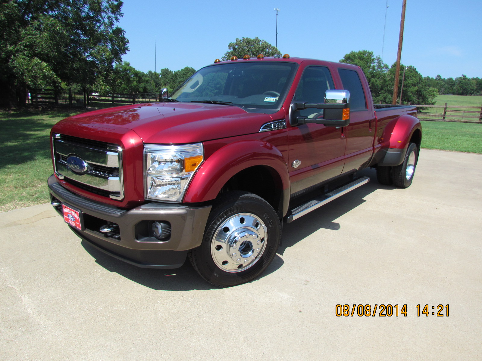

The highest rated pickup Ford builds is the F-450 which is rated at 40,400# GCWR. The 35,000# rating would be for an F-350.
The 450 is a higher class truck. So I wasnt comparing that. Ram makes a 4500 and 5500 also. But in the brief time I searched I couldnt find a similar chart showing them

Ram and GM do not make a 450 sized pickup. Only cab and chassis. Not the same class.

There's no reason Ram could not make a 4500 pickup. Their high capacity 3500 could be designated a 4500, almost the same ratings as the F-450 pickup. The F-450 is not the same truck as the F-450 chassis cab, actually has a much higher tow rating than the chassis-cab. The F-450 pickup is designed to pull, the F-450/550 chassis cabs are designed to carry. Ram could do the same thing. Excellent trucks.
   / 2015 Dodge Ram 3500 Trailer Towing Chart #30
Either way, it is unfair to compare a f450 to a 3500 IMO.
Comapre apples to apples. Dodge doesn't have a comparable apple. Maybe demand ain't there. If you need an apple, but the f450. If you are shopping for oranges, compare the 350 and 3500
