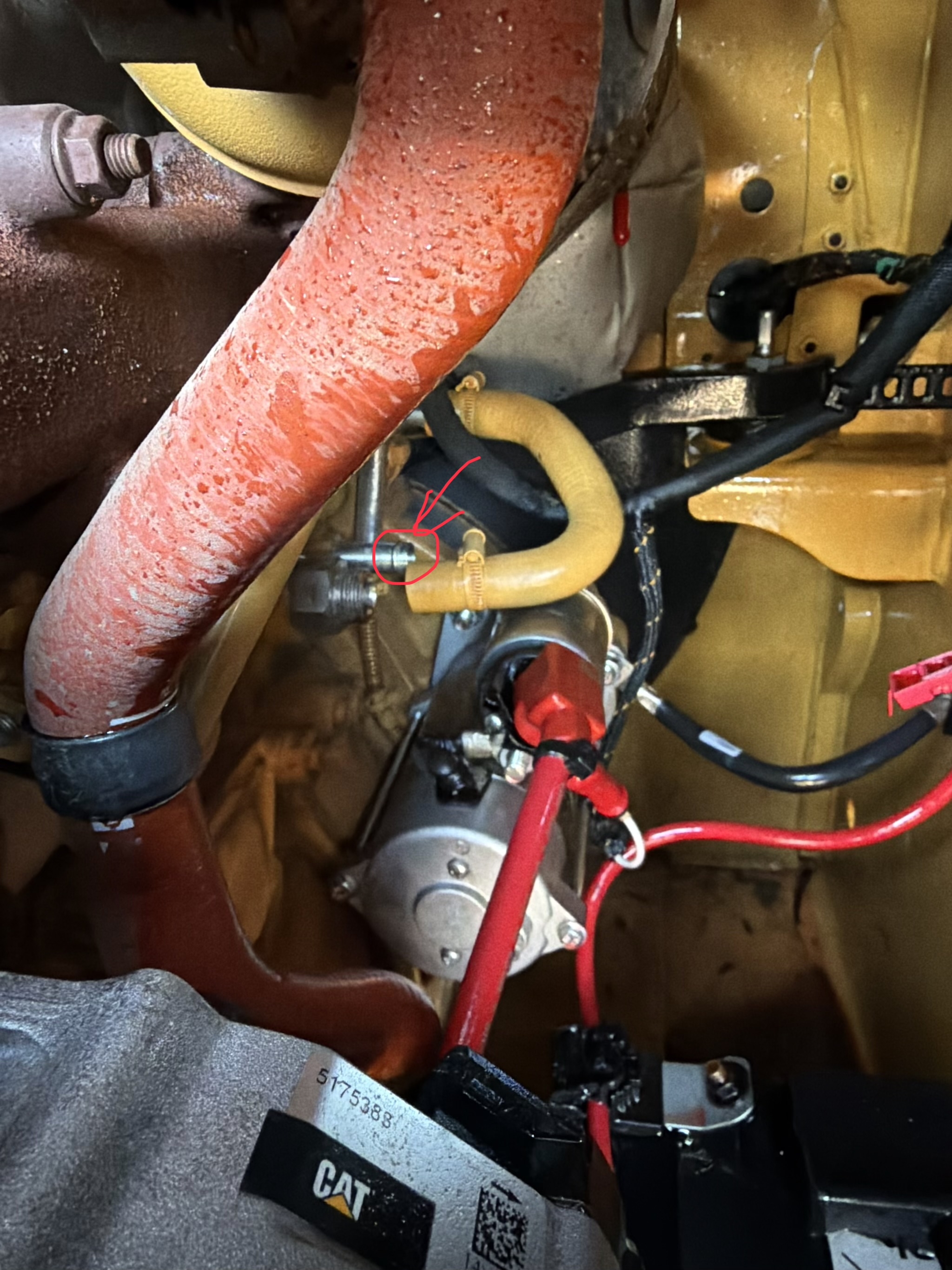

😳🤣 Oops! I was looking at the closer fitting.
All the best, Peter

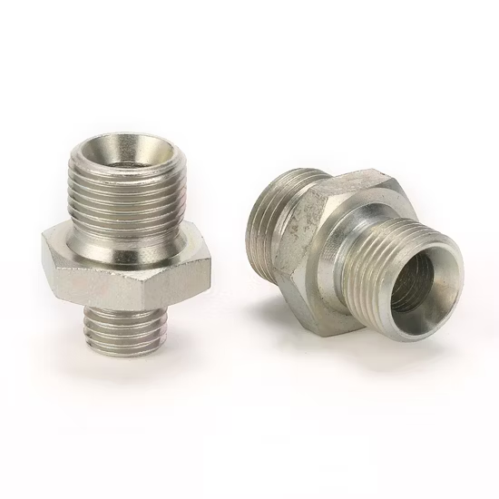

Fitting in foreground is cone seat, such as this:
yeah, you'd have a heck of a time getting any hose to stay on one of those. :ROFLMAO:
/ 2018 RAM vent #146
Yes, that was my thought, too. Inverted flares with threads aren't known for sealing well to tubing are they? 🤣 I was wondering if there was a fitting missing on that one, too.
All the best, Peter

If that CAT mulcher, with only 40 hours on it, didn’t have a high temp alarm, that motor would have been cooked in about 1-2 more minutes.
