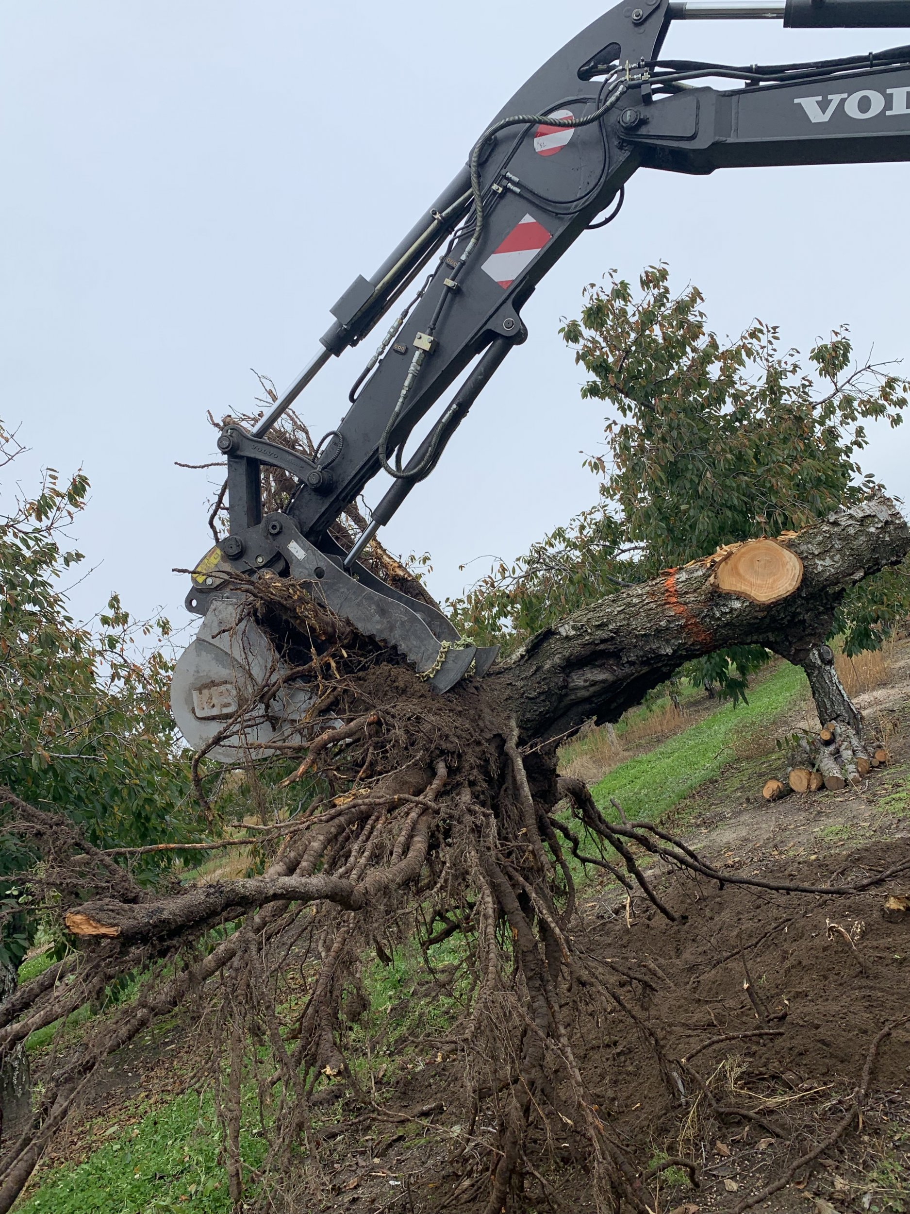

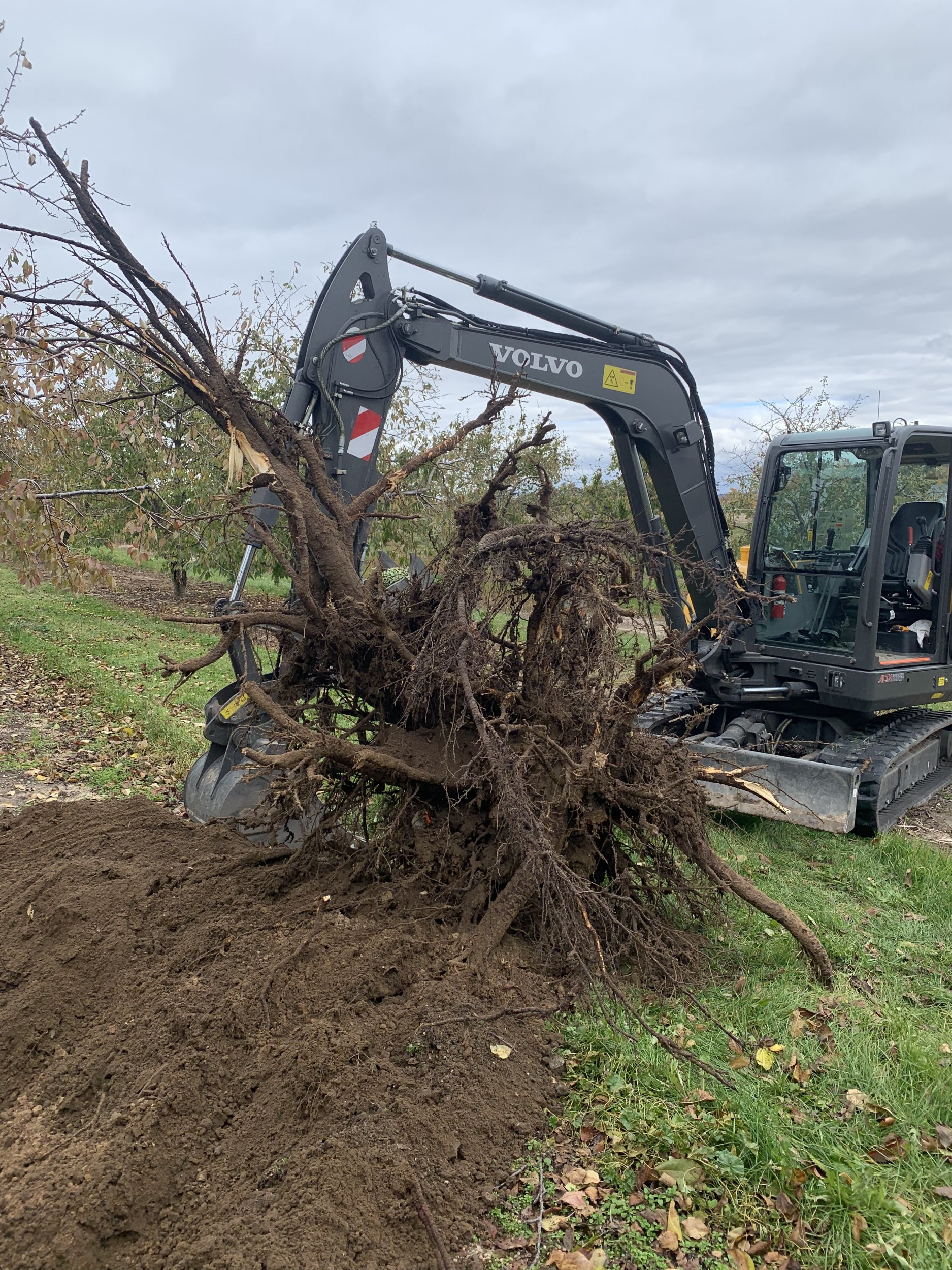

Congrats, that’s a nice size machine. 6 tonner is the size I bought for my jobs , mainly pulling trees . Still easily trailerable and maneuverable 👍

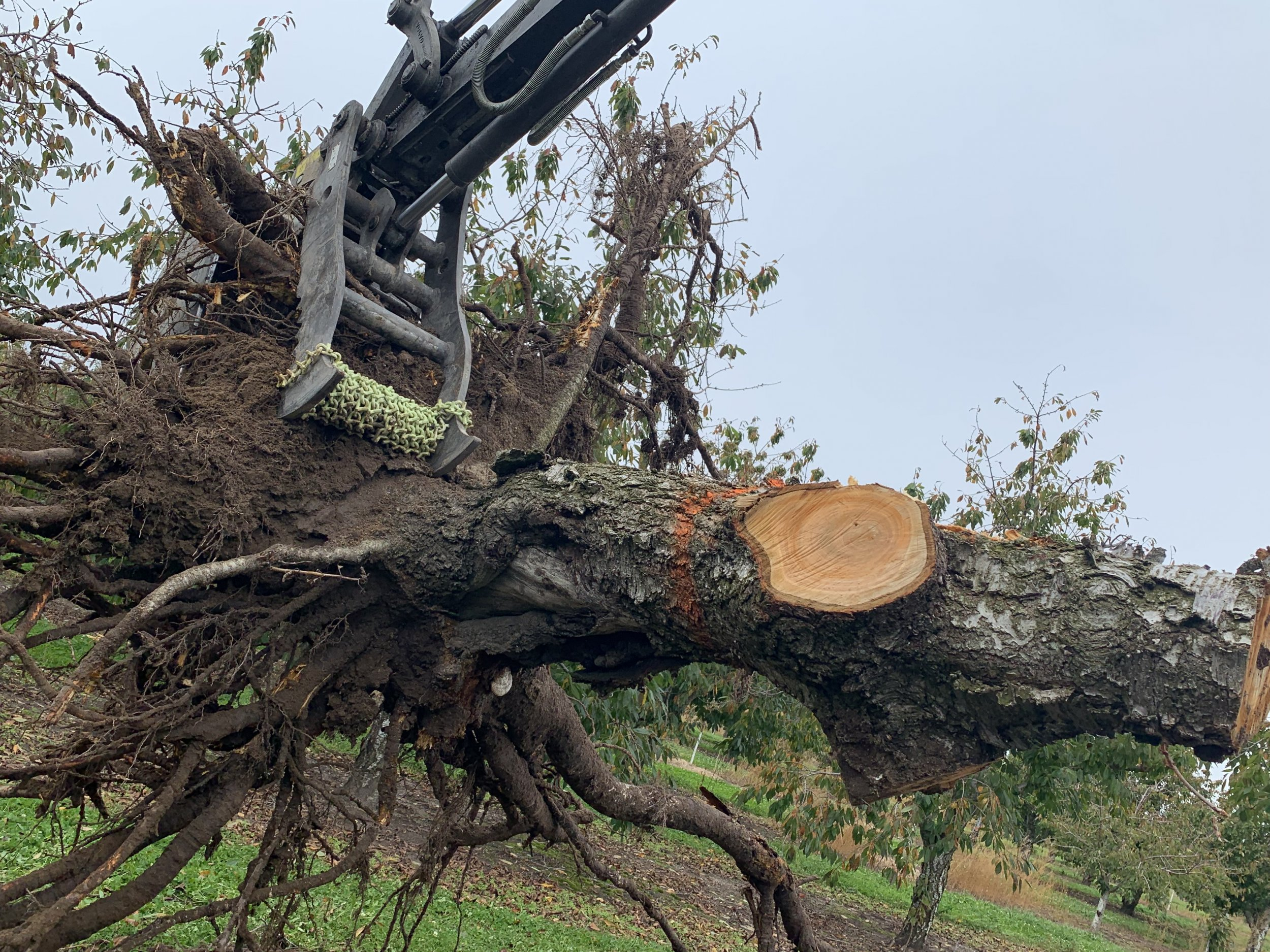

Nice. I used a volvo ecr45(I think) for a few weeks as a loaner a year or two ago. I liked it. How do you like the work brau coupler and bucket? And what is the chain on the thumb for?
   / 2018 tb260 is on the way. #4

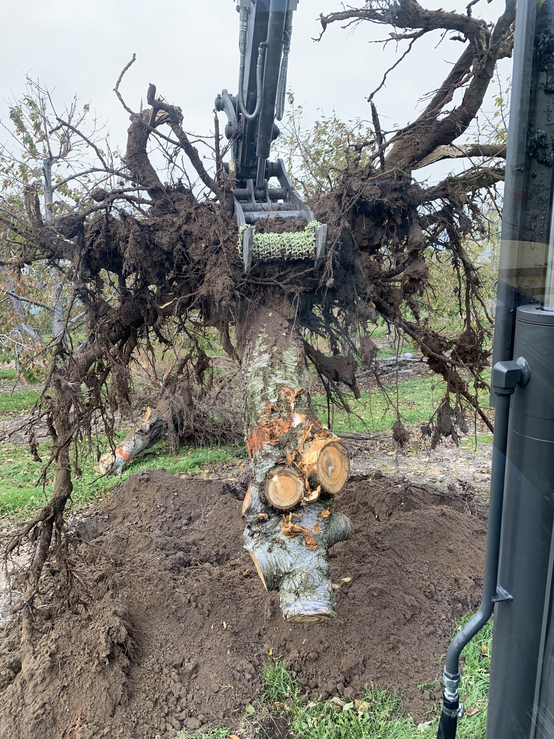

2’ WB bucket has been great , coupler is not WB , it’s Volvo pin grabber that came with it , after having a quick coupler I’d never go back to pulling greasy pins again 👍👍. The Volvo factory thumb rocks👍. Very well designed, I added the V link chain wrapped around lower crosspiece to easily get a grip on individual roots still in the ground. Squeezes against the two teeth it straddles, Works awesome. ( I made it from a brush grabber chain I had and never used) . Is yours coming with a bucket and thumb? I think you’re gonna love it , dam enjoyable to operate in cab comfort 👌

Better pics of chain,
