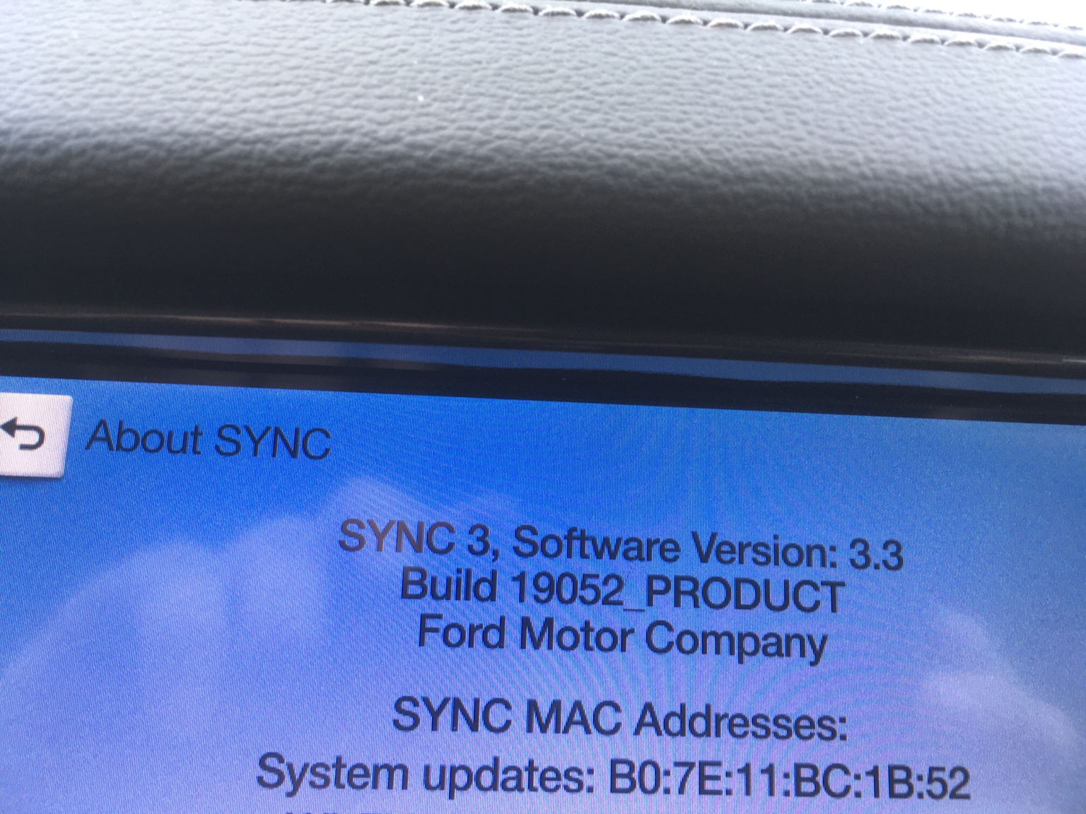

I have updated the Maps and software in my 2019 Ford Ranger. I opted to buy the USB flash drive and to install it during a road trip. It took 80 minutes to update the system from the flash drive. There were no problems installing it and now I have:
