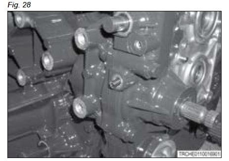

You want to add threads to a blind hole? They are certainly supposed to thread into the transmission casing-judging by the manual (see photo). The correct bolts were supposed to be 40mm but were 30mm. You can see maybe 2mm (more?) of bolt threads have eaten up the hole.
My guess is that with the wrong bolts there is only 2mm of bolt is showing after going through the plate to thread into the trans. Assuming then that the frame and plate is 28mm deep. There is only 10mm of thread in the casing.
So about twenty percent of the thread securing the frame to the tractor on that bolt is now gone-assume similar condition on the other bolts. You may not have the depth to add another 2mm of threads before boring through the case wall into the trans.
Unless the hole is made larger and tapped properly (which will weaken the boss), the only solution I would feel comfortable with is having the casing replaced and correct bolts installed. Engineers designed it this way for a reason. Also, as is, the lack of uniform compression along the entire thread path could may eventually cause a mushroom condition under stress and crack the end of the boss-that crack would sliver and shear down the side of the boss. This situation is completely avoidable if they just do the right thing.

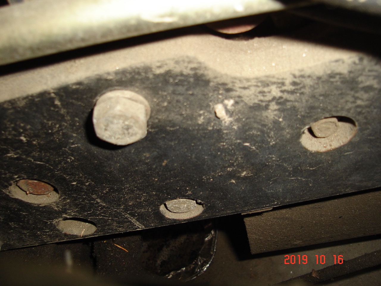

Lou-- I believe that's a factory thing, as the BH support frame that extends out to the rear is welded to the forward part of the frame that supports the FEL, at least on my 2310. I bet it's the same on the newer ones, too. That's a factory-installed option, which is why it's very difficult, if not impossible, to add a M-F BH later, and why I ordered mine with the BH.
Here's what mine looks like.. no extra charge for the dust! Note that there are those recessed bolts as well as some larger flush-mounted ones.
