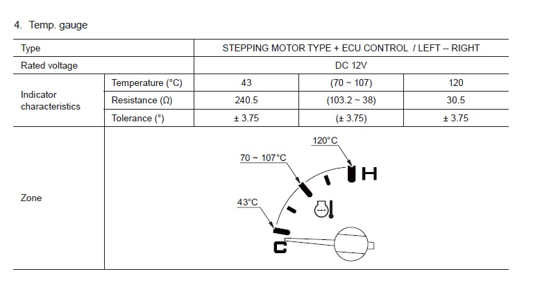

Took a screenshot out of the service manual for the 2020+ 15 Series. It has the new style dash that K5lwq showed on the previous page. As you can see on the middle position of the needle, it can either be 70ºC or 107ºC. Confirming what Eric said about being pretty much a 3 position thing.

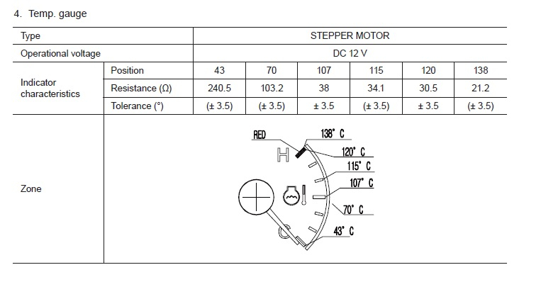

And the old dash style for comparison, showing temp variations a lot better.
Well you have an analog instrument driven by a varying resistance as a function of temperature which is how temp monitors work. Using some common sense here..........the needle will not sit in the center mark while the resistance changes as mentioned in the chart. The center point of the resistance posted is about 190F which is where my Ford 3910's thermostat starts to open and is a good temperature for running a diesel and expecting to maximize combustion efficiency.
My bet is that the intermediate marks are at 158 F and 232F. This isn't a 3 position instrument as claimed. If it were you would have 3 separate thermal sensors and when their temperature was exceeded a switch would activate and the meter would step function to the corresponding position......fat chance on that being the case!
One should expect the needle to rise linearly till it hits the center mark and then stay there while the thermostat continues to open as the engine heats, producing very minor variations in the needle positon. When the load exceeds the cooling capacity, then the needle will start moving again at a pace similar to the initial deflection.
If the needle gets to the hot marker, you had better cease operation because at 248F you are exceeding the ability of your 50-50 antifreeze and radiator pressure cap to retain the coolant in the radiator....
ALA boil over time!
They do the three position gauge with one sensor. The gauge is controlled by a hardware or software logic circuit, it's not analog like you're thinking. I have watched gauges like this in vehicles where I also have a direct read of the temp sensor via OBD2, and yep, "low" and "normal" positions cover a wide range of sensor values. Never got to "high".
Look at the manual pages ptsg posted.. the new style three position one is "stepping motor type + ECU control". It's controlled by software.
