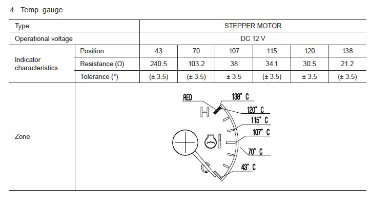

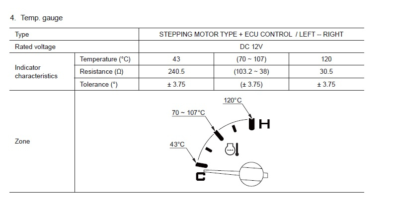

Took a screenshot out of the service manual for the 2020+ 15 Series. It has the new style dash that K5lwq showed on the previous page. As you can see on the middle position of the needle, it can either be 70ºC or 107ºC. Confirming what Eric said about being pretty much a 3 position thing.
And the old dash style for comparison, showing temp variations a lot better.
