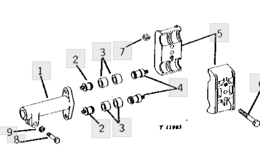

I stated you need to check ""frt hyd pump drive"" for worn bushings & possible worn clamps.

Oh, I just replaced that pump drive. I had to replace the radiator last month and all those parts are all new, but I'll take a look at it. I did torque it properly.

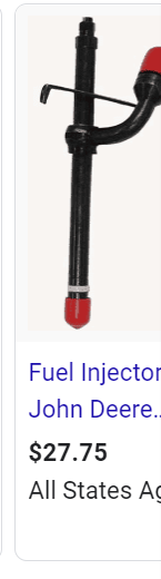

New injector should come with new seals. I suggest to have new injectors "pop tested" before installing. All-states injector is even cheaper,

New injectors did not come with new seals. I had bought some anyhow, so I'm ready. I was thinking that the compression nut for that seal would necessitate taking apart the injector at the top go put it on, but no, once the seal is out of the nut, both the seal and nut just slide over that 'nut' at the top of the injector. I have the old injectors out, it took me about 2 hours, not bad. I was worried about how to pull them out, I kept messing around and they don't just pull out easily. Finally I found an old claw type nail extractor, not the flat type the roofers use, they're too big, the kind you drive under a nail head with a hammer and it fit perfectly under that loose bracket on the injector and the nut by the side of the injector on the engine and it just levered them right up. So tomorrow I'll clean up all the parts, make sure all the old pipe nuts fit fine on the new injectors without binding and hopefully things will go back together easier than it came apart. The old injectors are certainly carboned up on the ends.
I may call a local guy that works on cars and tractors to see if he can test the injectors. Otherwise I'm just going to try them, it's easy enough to get them out. I can't believe this isn't going to help.
What I'd like to know is why this injector works for a million different engines. How does that work? You'd think each injector would have to be calibrated for the engine/displacement size. Or is it more a function of the injector pump?
