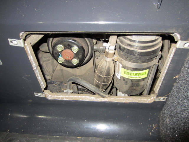

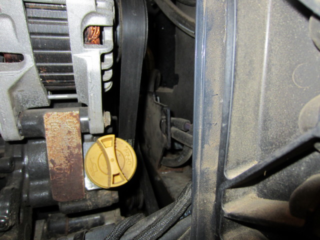

I'm not sure if my toolcat has the "bypass kit" installed but it may. I took pictures of the area looking at the fuel hoses and there is a valve tied with a wire tie below and to the left of the filter. It is where the hose curves down below the engine pulley.
EDIT: I confirmed the valve part number as the bypass valve so my 2017 unit has it.
View attachment 675922View attachment 675923
winter package on the 2020 is a block heater and larger battery, the hose you see is from the fuel tank, below is a 90 to the primer, left is the return from the injector pump, it is pressure operated to open dumping to the tank or thro the bulb to the filter

I sounds like the new ones are all coming from the factory with the fuel bypass kit installed. Right below is valve #7275950 (part of bypass kit) , then, the line for the bulb comes out of the bottom of the valve. Being that yours comes from the factory with the kit installed, I'm not sure where the valve is installed.
Too bad they didn't use a Tee that is more robust. It always works out we have to work on these when it is cold and all the rubber hoses are hard as rock.

The cold fuel by-pass valve is temperature activated, not pressure. At cold fuel the by-pass valve changes the return flow so rather than pass through the fuel cooling rail the goes directly to the bulb and fuel filter to help remove wax in filter. This system works when fuel is somewhere between starting to wax point and gel point, filter partially blocked. Then engine is able to run but at reduced RPM until warmed up.
A regular Tee in the there will probably work fine in cold weather months but in heat of summer you may experience performance issues and/or fuel heat codes due to not passing through the cooler.
