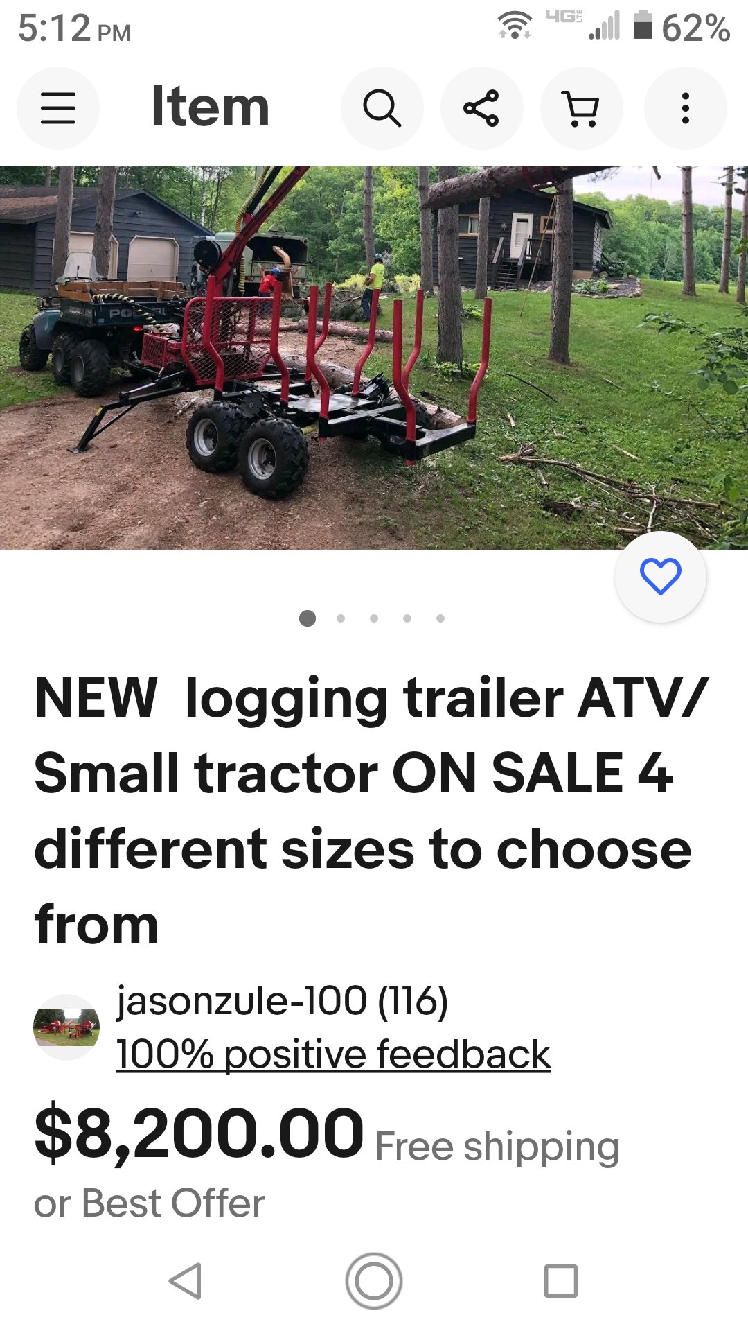

Interesting trailer setup to load downed trees into this trailer to be towed out via 6x6. I'd say pods were not need in that low volume of snow. What does that idler wheel between the axles do on this trailer?
   / 2022 Outlander Max 6x6 #220
Drive sprocket to independently propel trailer from loader hydros if they put tracks on that rig? Cool set up
