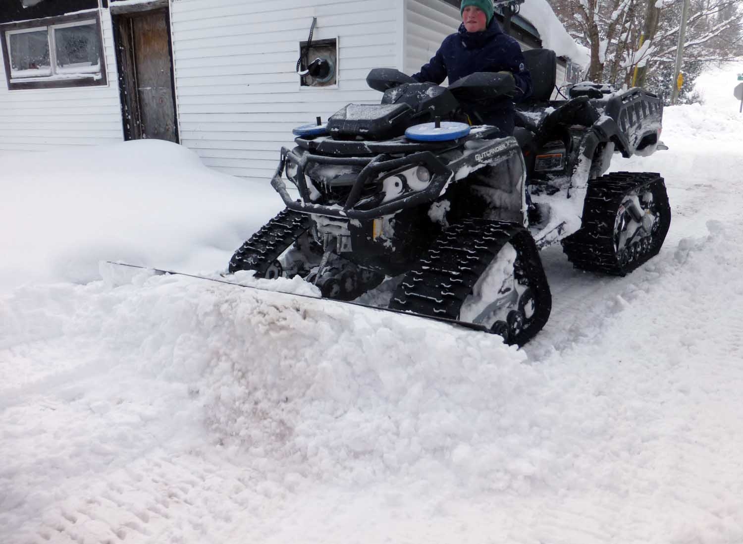

I'm also updatingor reinforcing the plow since its the off season now. This machine sees 90% of its hours over the winter..
