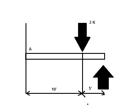

Position A is the push frame assembly where its attached (via pins) to the atv. This is the point the blade is normally pushed with.

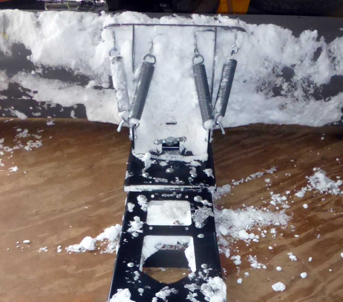

2K is some hard wet snow on top of the push frame and keeps that assembly from its normal rising.
The right most up arrow is your 5000lb winch that is going to lift the frame anyway. With 2k in the way, something will be bend.
No compression force is being exerted on the push frame.

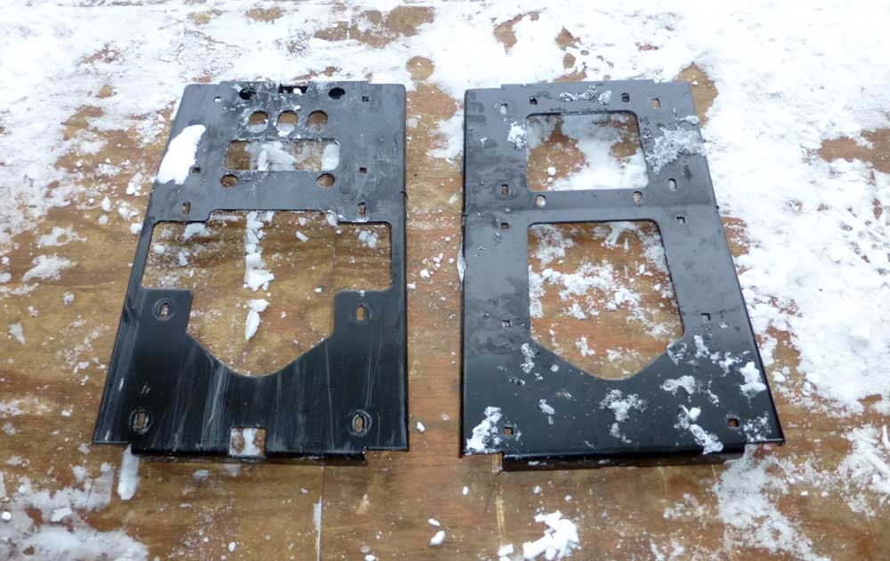

2,000# of snow? If I get this right, the (flat) stiffener sections allow for snow to build up and (compact) to the point that it's the same as jamming a log in there and then lifting. What's to keep that from happening again? I'll say it again - flawed design.
   / 2022 Outlander Max 6x6 #356
Sometimes lighter weight areas are engineered as sort of "sacrificial" components to keep more expensive and harder to access parts from being damaged. Sounds like ArlyA understands what happened.

Maybe put a little A-frame "hat" over that to keep packed snow from falling on it and accumulating?

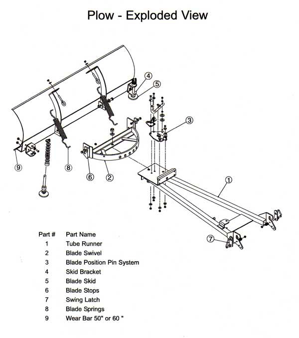

Can't add much there, it fits right against the machines underside when fully lifted and I wish it rose more than it does now. I might need to build my own push frame and leave off the reinforcements that KFI had added. In the below print, you can see the push tubes don't have many cross member to hang onto snow. Would need to use stiffer tubing.

I don't know where the attachment point is to the ATV; I don't really have a reference for what the weight was.
I'm guessing that your drawing with 10' & 5' & 2k# was just an example forces drawing as I'd assume that the entire length of your lever arm & plow isn't 15' long...
so was the hard snow buildup on top of those plates, getting squished by the winch lifting between the frame and the bottom of the ATV?
