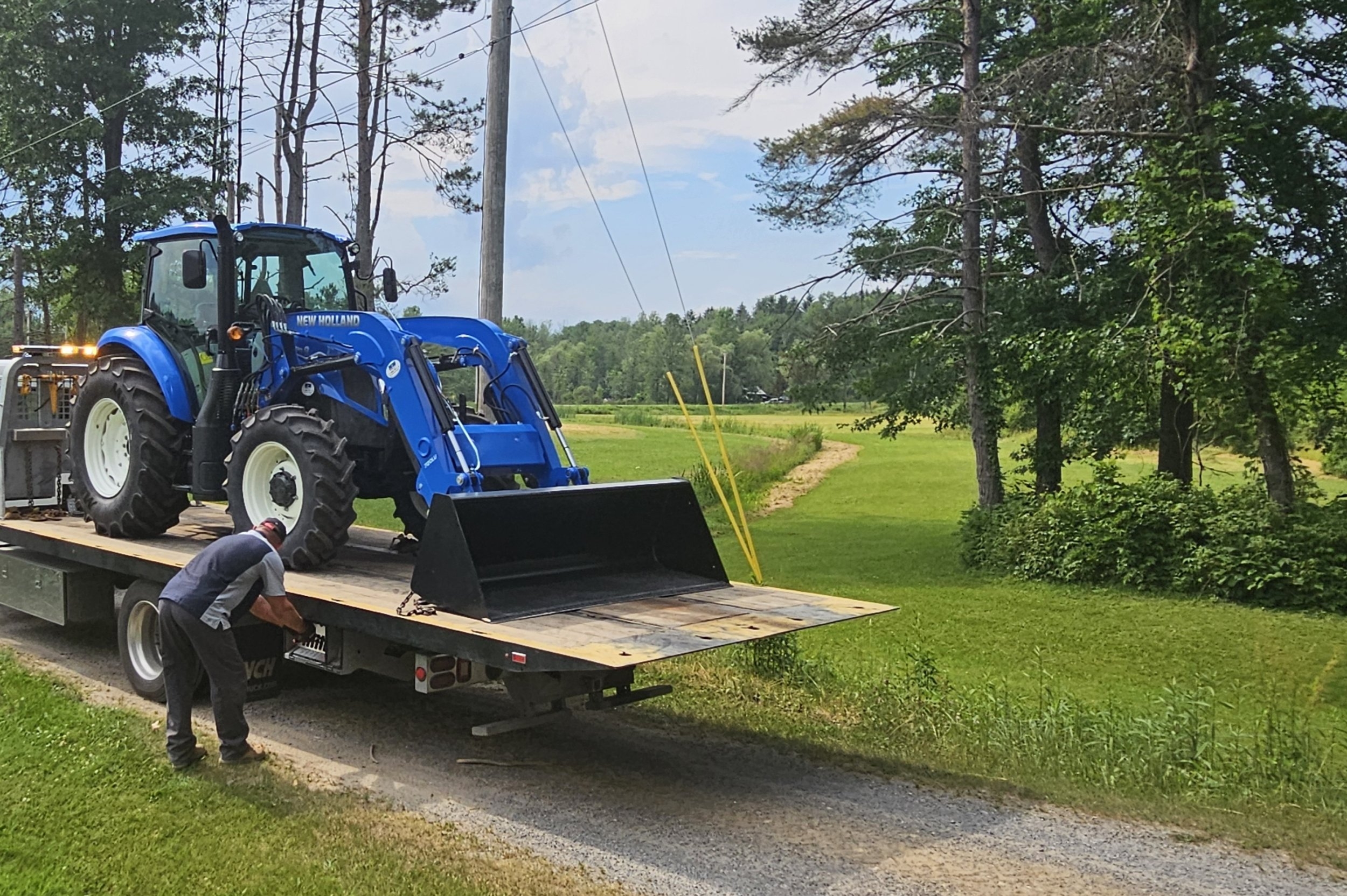

I'm glad it worked out for you sorry it's been a while but I solved all my trouble after dealing with New Holland on many occasions and having other issues including another problem with the computer I agreed to trade the tractor out and got a pretty good deal as I often State my dealer takes good care of me. As some of you know I was thinking about buying a Massey Ferguson but after looking at them and once again only having three cylinders in the four series I decided to go with a Power Star I am really partial to New Holland not to mention my dealer is a 10 minute tractor Drive from my house. So on my birthday June 19th I bought myself a very expensive Power Star can never complain about the size looked at the Power Star 75 not much bigger than the workmaster so I went up to the 120 horsepower with aggressively larger tires than stock very happy so far no issue with the PTO or computers but time will tell take care and thanks for all the opinions.
   / 2022 work master 75 pto too fast shutting down ??? #45
Now that's a TRACTOR ! No toy there. lol

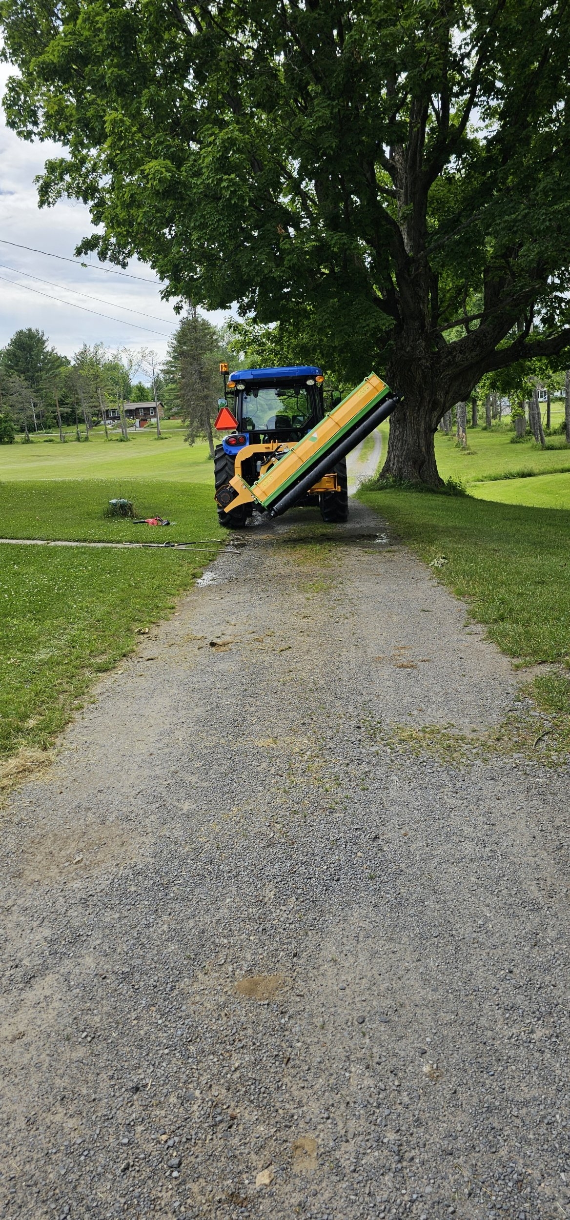

Yes it's definitely more tractor than an old retired guy needs but I got it for a really good price and with the 0% financing it was worth doing. The sad truth is the workmaster 75 is a very good tractor handle everything I asked it to do without issue even an oversized offset flail which the manufacturer recommended 85 horsepower and bigger I'll attach a picture it really handled it well of course the new tractor won't even know it's back there but then again look at the price difference. If they would just go through those machines and take a little more time with some of the simple things like the PTO the PTO engagement cable which is an absolute joke made of pot metal that snaps every 3 months or at least it did for me and at my age it's not like I'm Mr Olympia LOL ridiculous for the price it's a very good tractor the frame is solid and I could never complain about the loader I never found the tractor ever under power at 75 horsepower and roughly 60 PTO for a three cylinder it had a lot of guts.
   / 2022 work master 75 pto too fast shutting down ??? #47
Nice tractor. Congratulations
