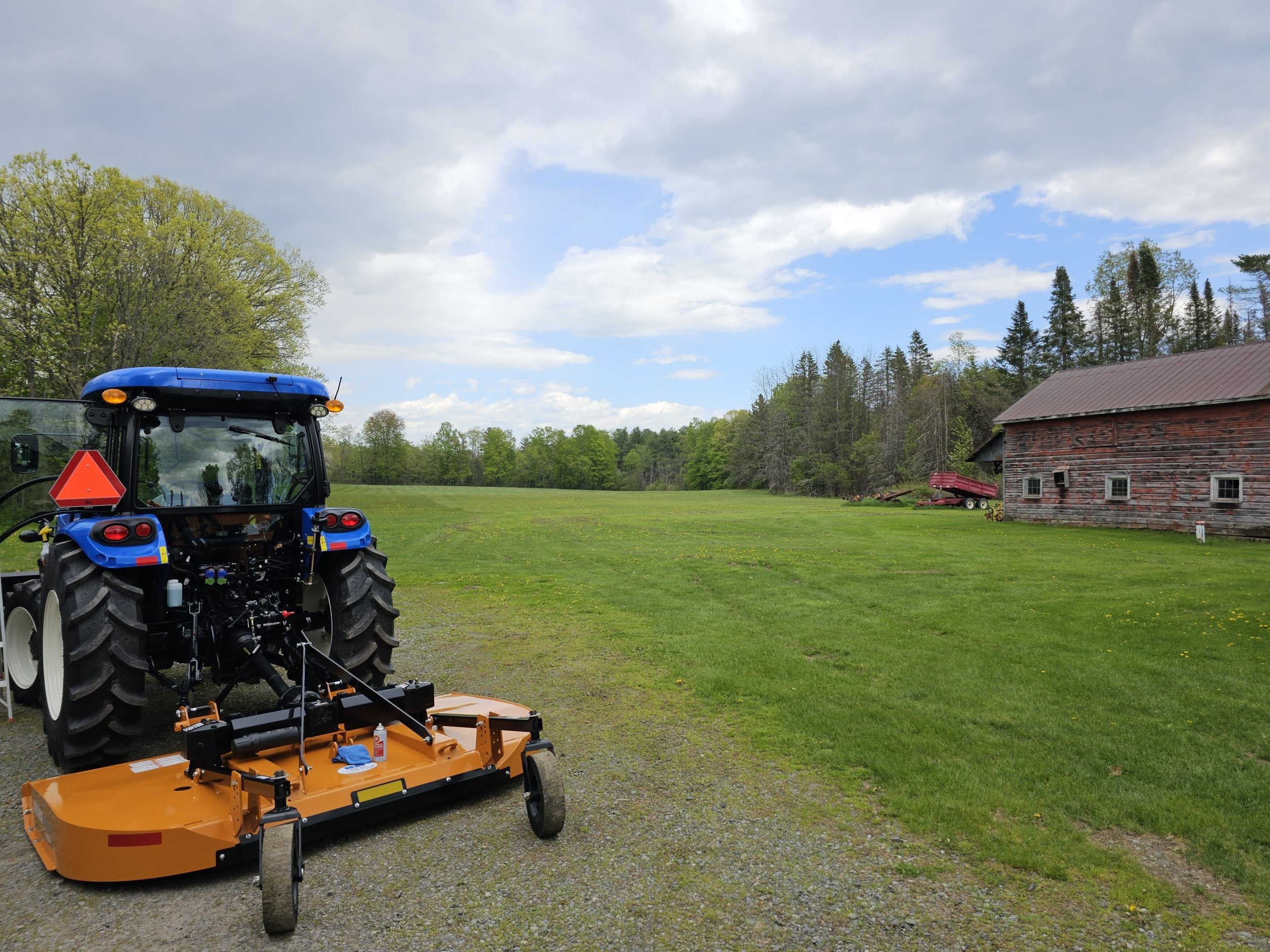

Well unfortunately today we just picked up the new bush hog that finally came in and my worst fears are realized. I tried slowing it down turning it off and Bam what a sound ridiculous I'm done with this BS the blades locked over each other so you have to get underneath and bang them apart or the machine will not start up without bouncing off the ground what were they thinking with this design it just doesn't make any sense that you would have that much mass just come to an instant stop and apparently there are no adjustments or any they'll tell me about ridiculous
That really is a crazy design and not good. My Kioti NX4510 HST just disengages and winds down when the PTO is turned off. It is electrically operated. Why would a company put a PTO brake on a tractor.

Just about all of them these days, with the electric over hydraulic PTO clutch pack. Your NX has a spring applied PTO brake too, either it's already wore out or it's just a lot more gentle stopping the PTO.

Lou told you what to do in a previous post. Get yourself an over running coupler, real simple. Actually preferred as it removes the shock load from the implement as well as the internal pto brake. I run them on all my implements that don't have it built into the driveline.

They probably did that to mitigate pto brake clutch failure and far as an abrupt start of any implement, the addition of an adjustable multi plate slip clutch in the driveline will eliminate that issue entirely.
Most of my quality implements including my disc mower (which happens to be a New Holland) as well as my new Kubota BV round bailer have them factory installed and so does my new pto driven stump grinder.
My Land pride 9 foot brush hog didn't come with one and neither did my 15 foot bat wing fold up shredder but, I added them anyway.
A slip clutch in the driveline as well as an over running coupler will totally eliminate and and all driveline shock when starting up any implement or stopping them when any implement will drive the disengaged pto stub. The pto will come to an immediate stop and not rotate at all and that totally eliminates pto brake wear, which is something I needed to do with my large frame Kubota's as the Kubota pto brakes are marginal at best and replacement requires splitting the tractors, which is a very involved process and if done by a dealer will be extremely expensive.
Tractor Supply sells them, I believe the Weasler brand but they can be had cheaper on line. Never replaced a shear bolt on any implement I own other than my own stupidity like sucking up a paving brick in my snowblower and locking the impeller.
My final comment is, quit whining and take care of the issue. I've laid out the plan in detail as to what to do. Up to you to remedy the issue. if you cannot do it yourself, have your dealer install a slip clutch. Far as the over running clutch on the pto stub, that is totally plug and play.
Do keep in mind that you will probably have to shorten the sliding halves on the driveline to compensate for the additional length of the slip clutch as well as the over running coupler and I presume you know how to do that. If not, have the dealer do that as well. he knows the procedure.
