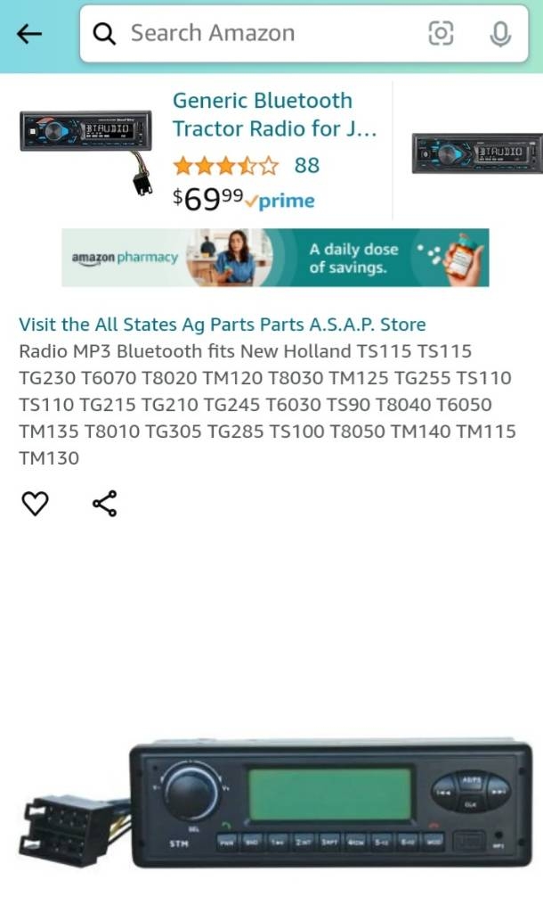

Maybe simply order this $70 one from Amazon and be done with it?
   / 2023 New Holland Radio Help
#13
Maybe simply order this $70 one from Amazon and be done with it?View attachment 819562View attachment 819563
Yeah, I'm kinda at that point now.
