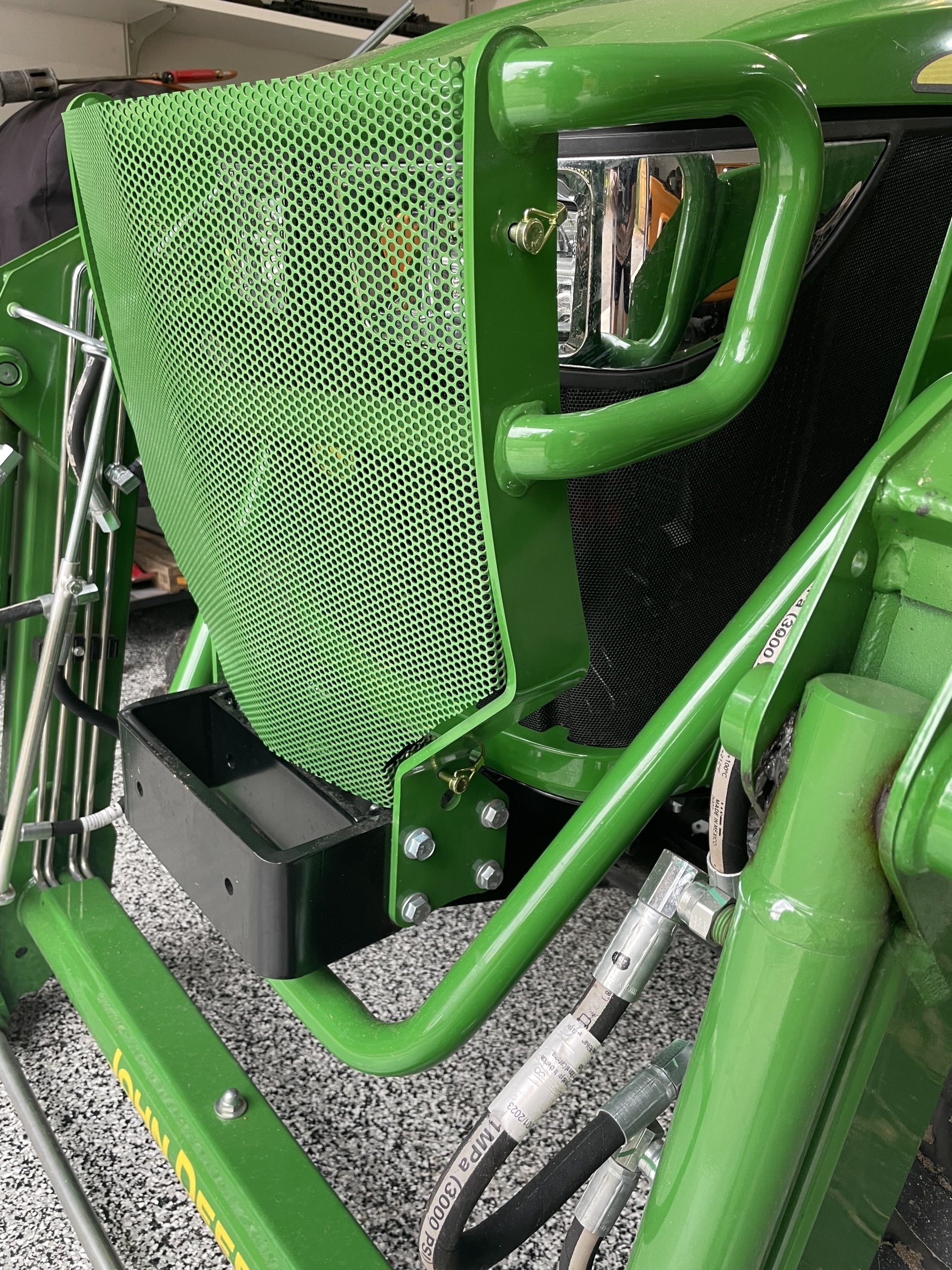

I ended up making one. $40 for expanded metal at Menards and a can of John Deere green paint and four pins, about $60 total into it, I think it looks good.

Nice work for sure, looks "factory".👍
Just remember that you're not superman regardless of any additional guarding. Expensive body panels and coolers seem to be almost an attractant to sticks and branches.

I know my limits but on my 2025r I had a branch come up through the opening and rip the u-hook off the hood, never realized it until I went to shut the hood and it wouldn't latch so I made this as soon as I traded tractors.
