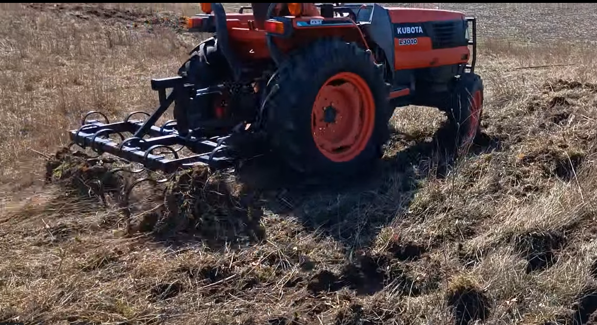

/ A backwards disk chisel, (chisel disk?) to make food plots #16

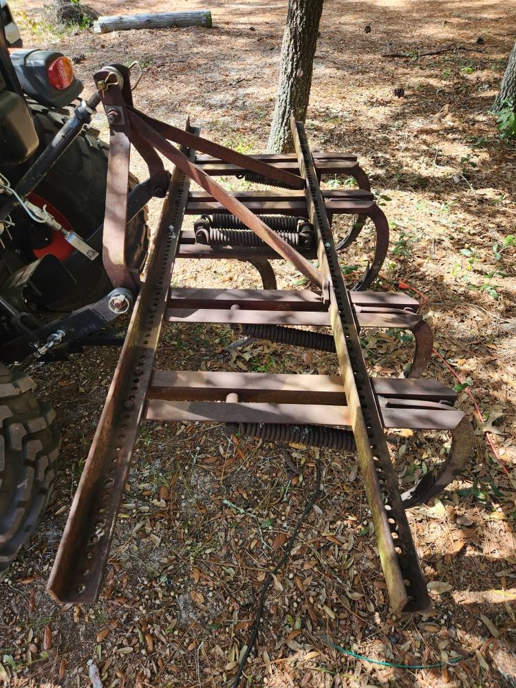

I'm not sure what part of the world you are in, but within a 1h30m radius i found 3 chisels of me. Two of them are cheaper than a working used disc.
I think a chisel/all purpose plow/field cultivator (they use those names interchangeable) likely fills about the same roll as a disc, but with deaper penetration. A chain harrow afterwards (also a pretty cheap impliment), will do a good job smoothing and covering the seed.
As a replacement for the chain harrow, bolting 5 tires together, flat way, and dragging will also work,

For a true chisel, maybe, but the light spring chisel, or the field harrow/all purpose plow, my 25hp engine will pull 7. Thats in sandy soil, but that old Ford 5000 could probably pull a good sized one with zero issue. A used 7 ft one, 9 tine, likely you could pull faster than you butt can take in the seat.
