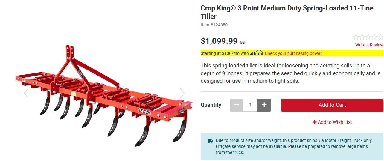

The 1100 dollar one I mentioned is the crop king sold by Agri Supply. Seems like an OK unit, but I dunno how rugged.
Looked around and I can find some pretty big chisel plows around but they’re 8-9 footers. Think my ol girl might not like that. But I suppose I can use the torch and make em a 7’ 3 pointer.

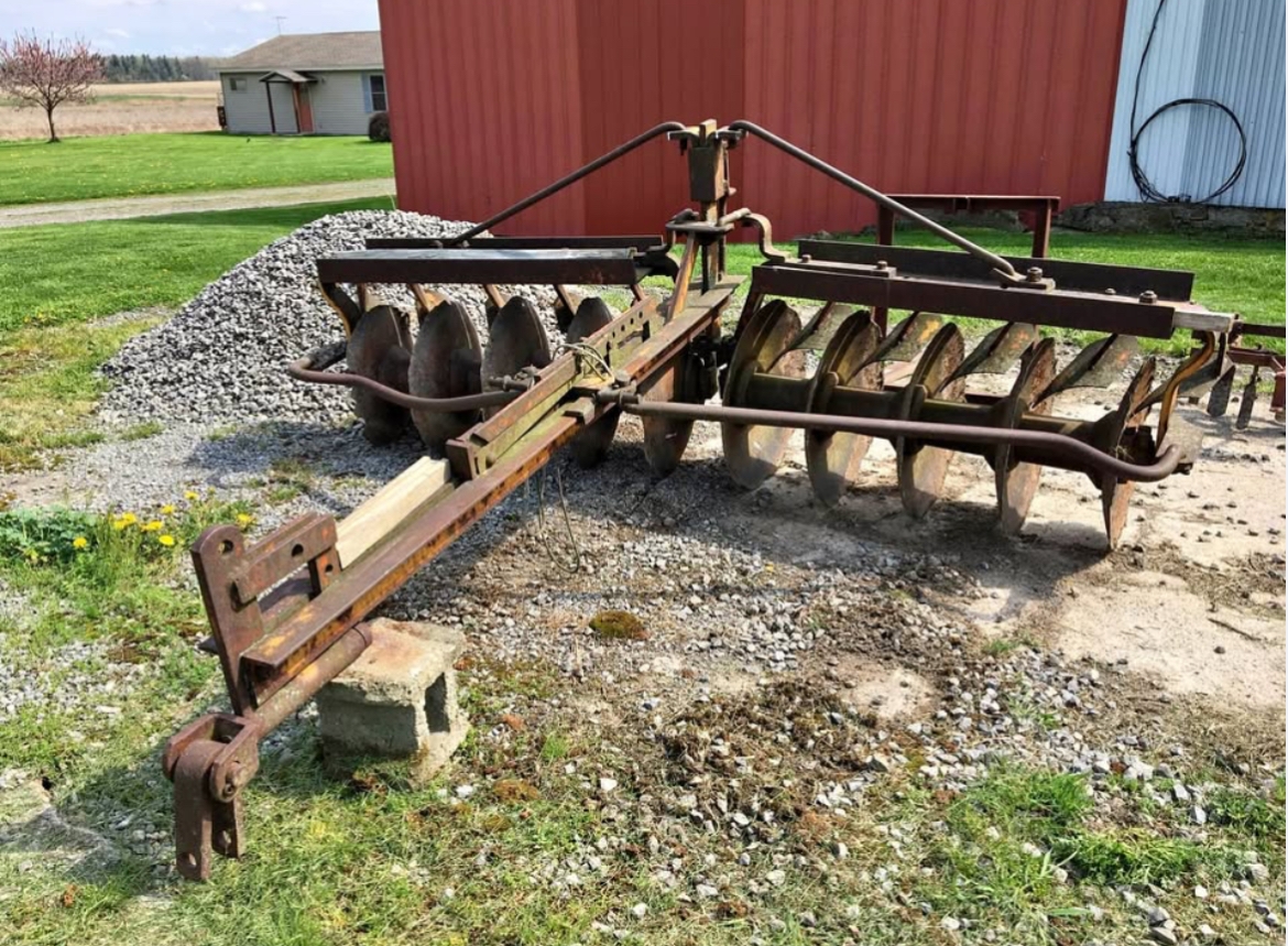

I am all for a no-till or minimum till method but the ground has to be establish first, you can't do a no till or even minimum till in virgin ground. Any tines type attachment wont do much other then scratching the ground, there's a reason it hasn't been done. Bottom plow your area and disk it, then removed the rock and even then you will have a hard time plowing it with all these rocks.
Maybe I’ll look for an Oliver 3 bottom, paint it up, use it for this and whatever else and have a yard ornament when it’s all said and done :)

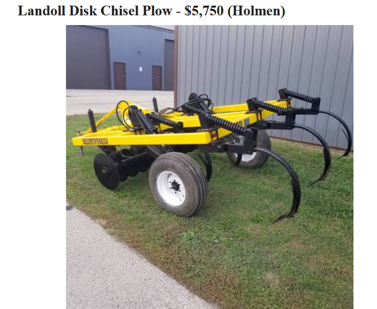

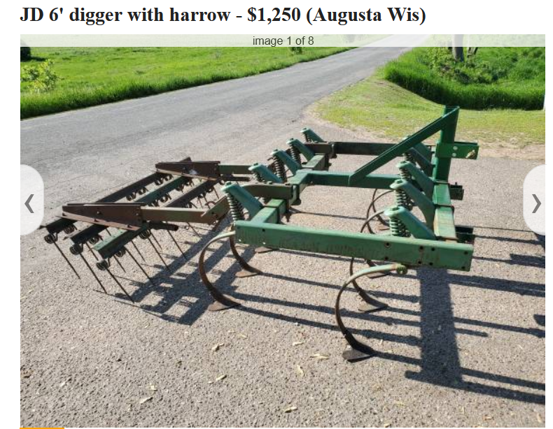

So, that APP is almost the same as what I got, although mine is an older Massey/Ford/deerborn/who knows. It does a good job, and actually is better heavy duty, as long as A, you going at a medium slow speed, and allow the springs to trip and reset; and B, you don't turn to sharp with then down. Replacement complete tine assemblies, with springs, rippers, and tips are like $111, so not cheap, but if you do need to replace 1, it's not the end of the world.
It should pull those rocks up towards the surface, for gathering, piling, ect.
