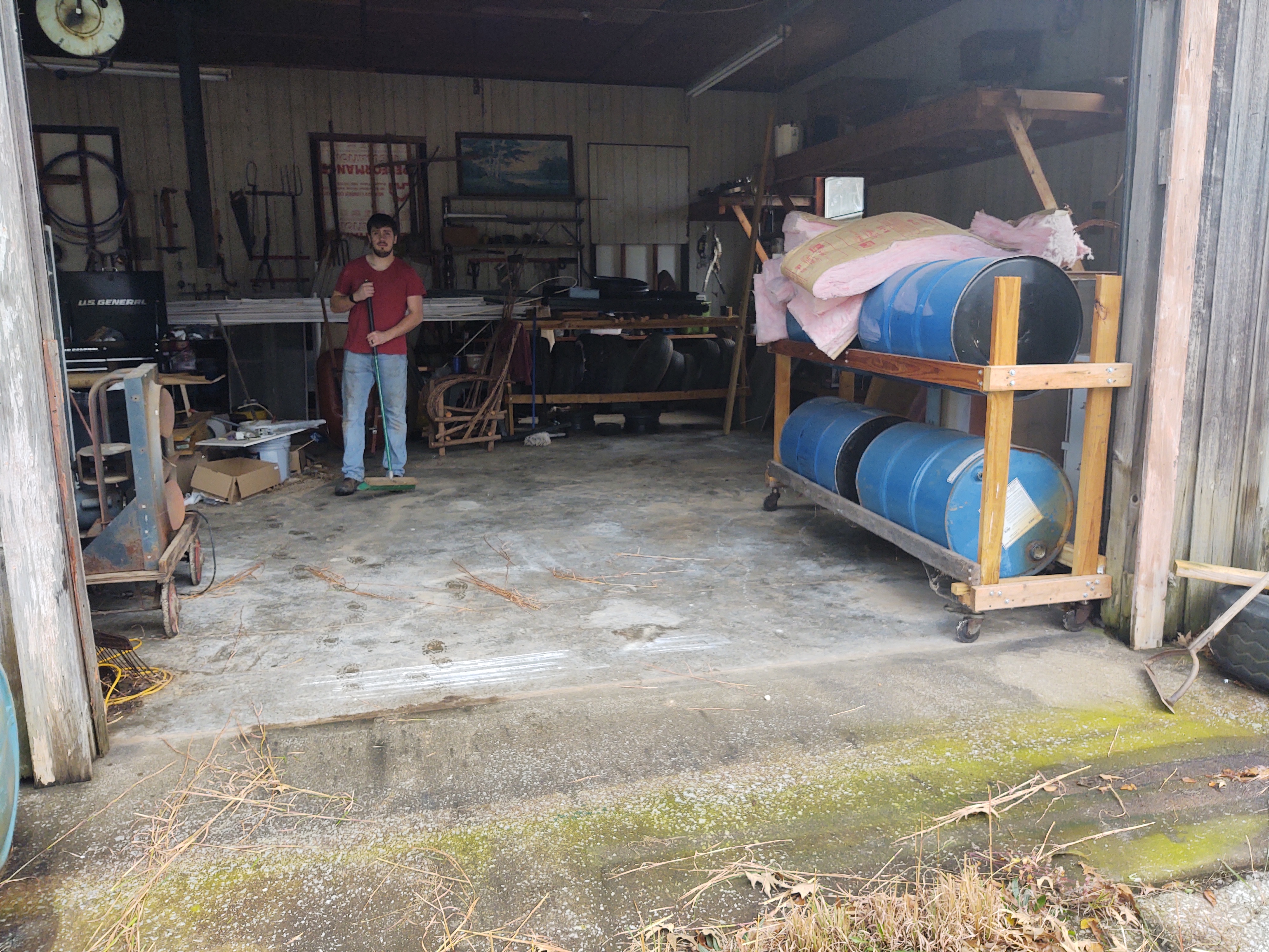

The shop made rebuilding the house much easier because we had a place in store building supplies, etc but we had never used it as an automotive shop until a teenager ran a red light totaling our 2016 Nissan Leaf SL when our daughter was taking the wife to work. Last we made room in one bay and got started stripping of the damage.
This was after we made some room in one bay.

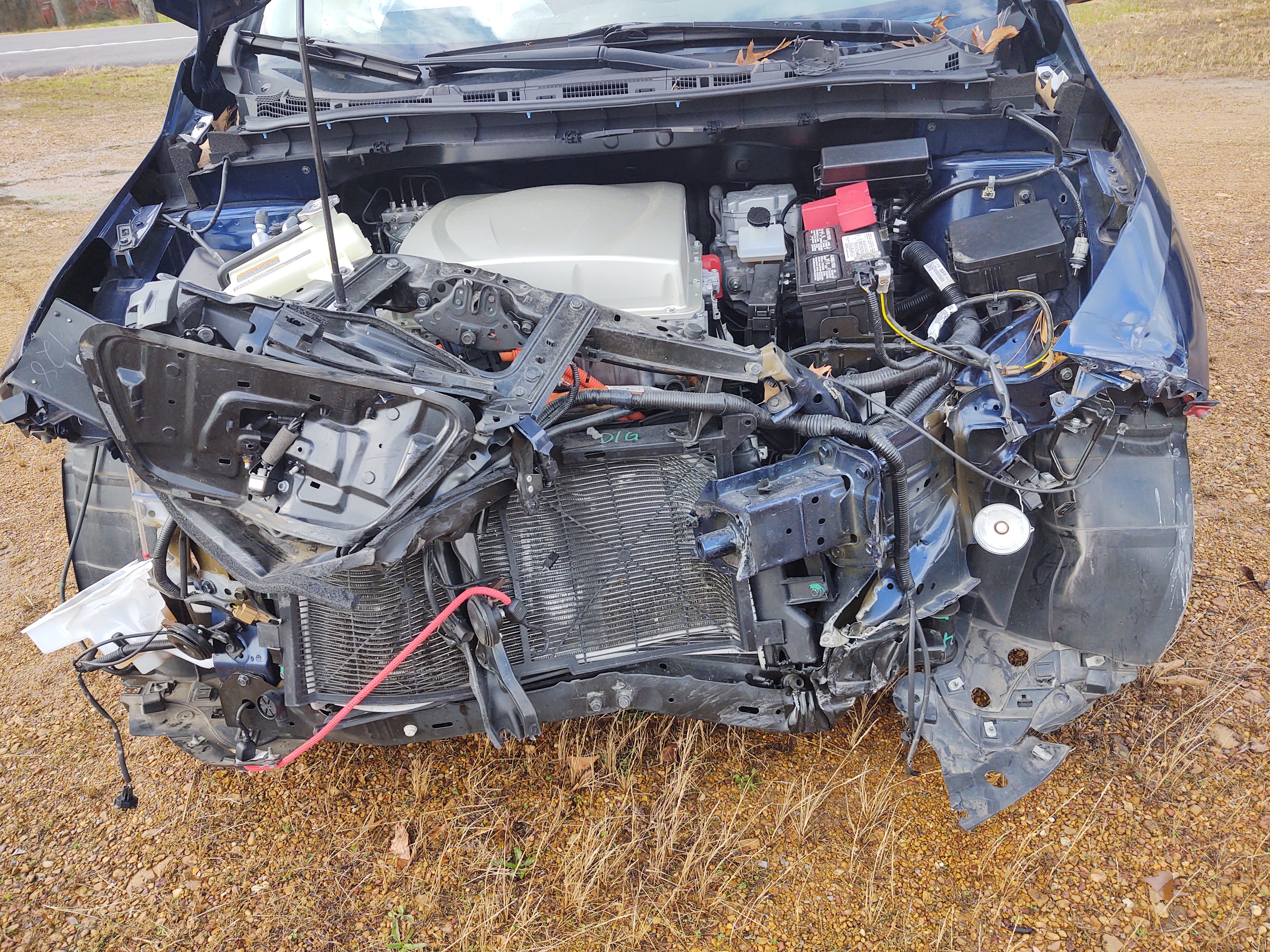

This was the Leaf post accident.

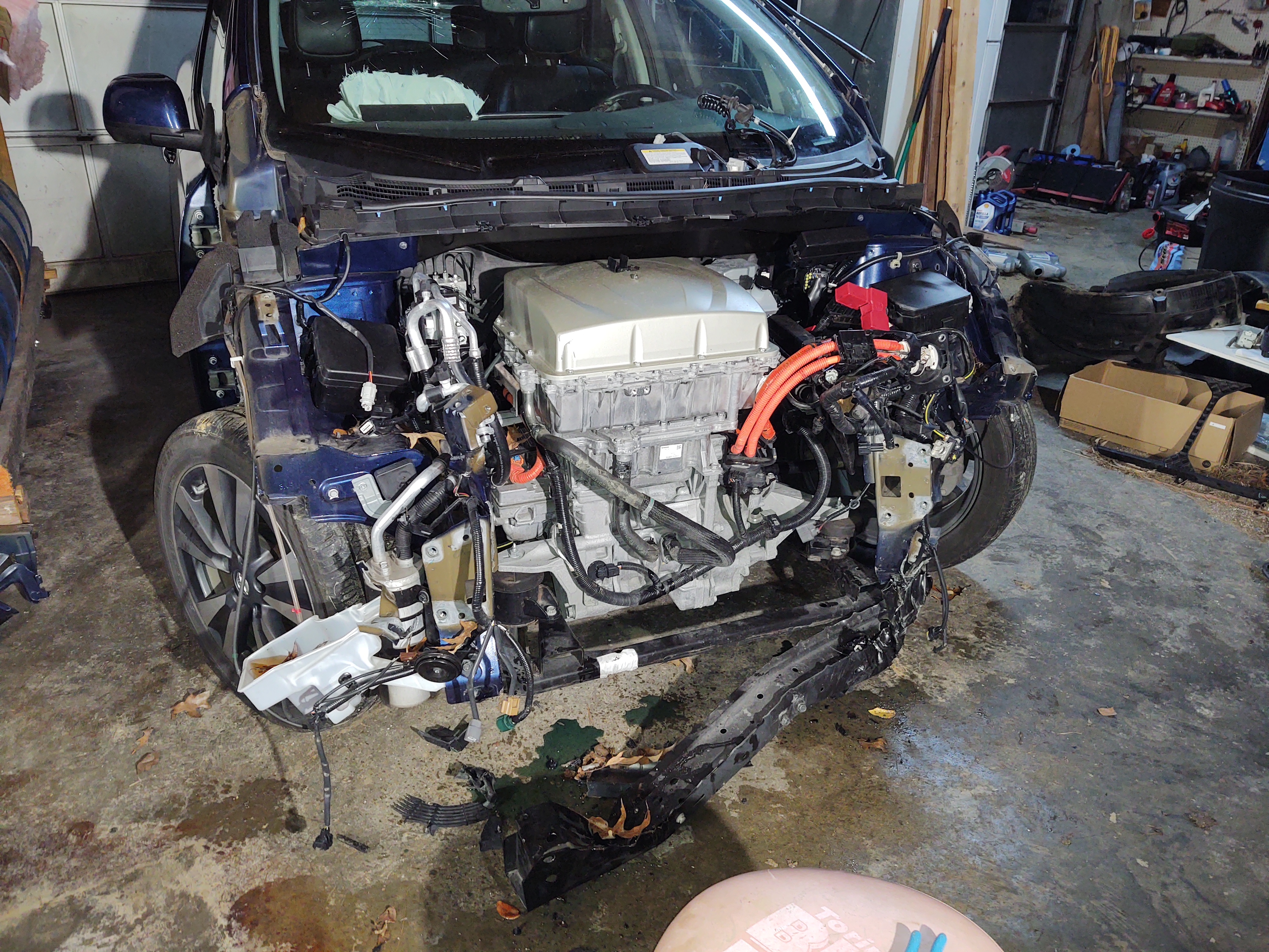

This was after we unbolted the damage that took us about 6 hours because we trying figure out the reinstall process. I thought we had lost the front camera but it was in the tangled mess and still worked. Most donor cars will not have that option.
We have since driven it a couple miles after stripping it down and it drove out fine but did not get it pass 68 MPH. Now we are looking for a parts car to make the rebuild work out $$$ wise. They are not cheap in online auctions. Sometimes the fees are nearly as much as the winning bid.

The mint like red 2015 Nissan Leaf with 27K miles we bought for a parts car if we could not resolve the electronics failure that lead Erie Insurance to total out is going to be our parts car. We failed to find the issues as to why the car will not charge and move and spring is here and gas prices are on the rise.
A body shop owner came by to look at our car last night and gave us a price to straighten front bumper brackets and turn the front cap Deep Blue Pearl. Thankfully our 2016 is still driveable so we will load it on the tilt trailer and take it and the parts that need painting to the shop. After our car is back from the shop we will start to moving the parts from the 2015 to our 2016. The van that ran the red light sheared 18" off the nose so we do not know what all is missing so it is good to have a 100% intact car for parts so we have something to go by. Since the charging ports got messed up and everything else this will not be a fast task to sort through but it is doable. The air bags and windshield should be interesting one way or another. Since the 2015 has not been in an accident I think we have a shot at getting the windshield out without breaking it.
