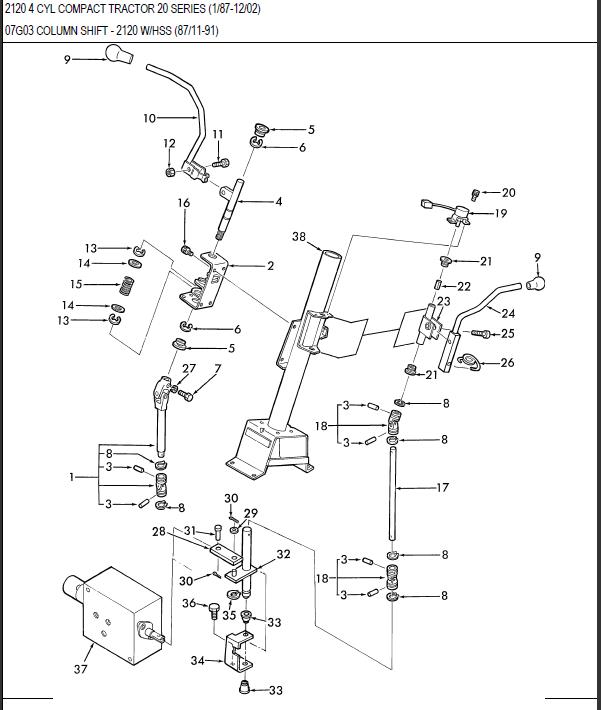

just bought a 1991 2120 with shuttle shift sometimes it shifts hard .changed trans /hyd oil and filter man where they dirty.put new filter on and added new oil still shifts hard like hyd clutch is not working right .I was wondering if there is a way to flush out the system .add diesel or is there a trans flush i could buy . the clutchs don't slip i have used it to move dirt and it will spin the tires in 4 wheel drive .any thoughts thank you Harold

Ah, I misread your first post. You has a HSS not a Electronic hydraulic shuttle shift. The Forward N Reverse lever goes to a hydraulic spool valve on the steering column, correct? I think I have the shop repair manual for that tranny.

I adjusted the clutch pedal. It shifts hard [the lever moves freely] when I move shift lever from f to r without using the clutch pedal ,the guy I bought it from said you use the clutch to change gears not f to r.But when I use the clutch pedal it is slow to engage and is at the top of pedal.Seems like the hyd clutch is not working right.
   / 2120 lazy shuttle #9

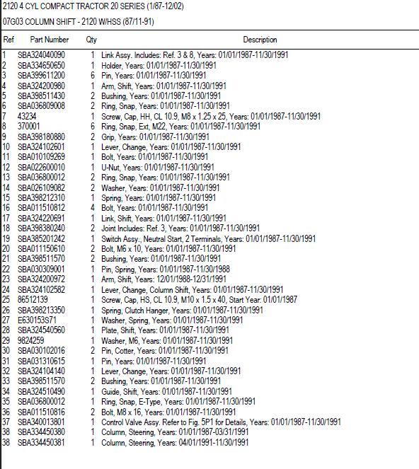

I think there is a hydraulic clutch pack controlled by the FNR lever on that model. There is an adjustment for the relief pressure as well. They had 4 available transmissions for that model. Make sure which one you have. The manual says units produced before S/N UV-25075 do not have the mode command switch on the dash. It could be the clutch pack pilot valve is not working. It is controlled from a small cable attached to the clutch pedal. Do you have a small cable as well as a clutch rod on the pedal.
Here are 2 sheets showing the shift valve. Is this what you have?

the cable to the lube cutoff spool was missing. installed a new one, clutch seems to be a little faster at engaging,when i use the pedel ,but shifting f to r is still like poping the clutch it grabs and spins the tires.changed the filter again and it was dirty. friend of mine wants to adjust the relief valve .hop that helps i can't believe the tractor is suposed shift that hard
