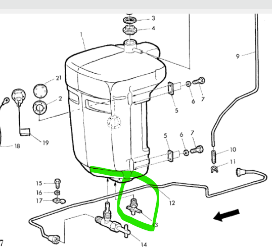

2130 parts schematic I'm viewing shows fuel tank has a fuel drain cock in the bottom of the fuel tank.
Jim beat me to this too! Since you have the bottom fuel line, also a bottom drain.
