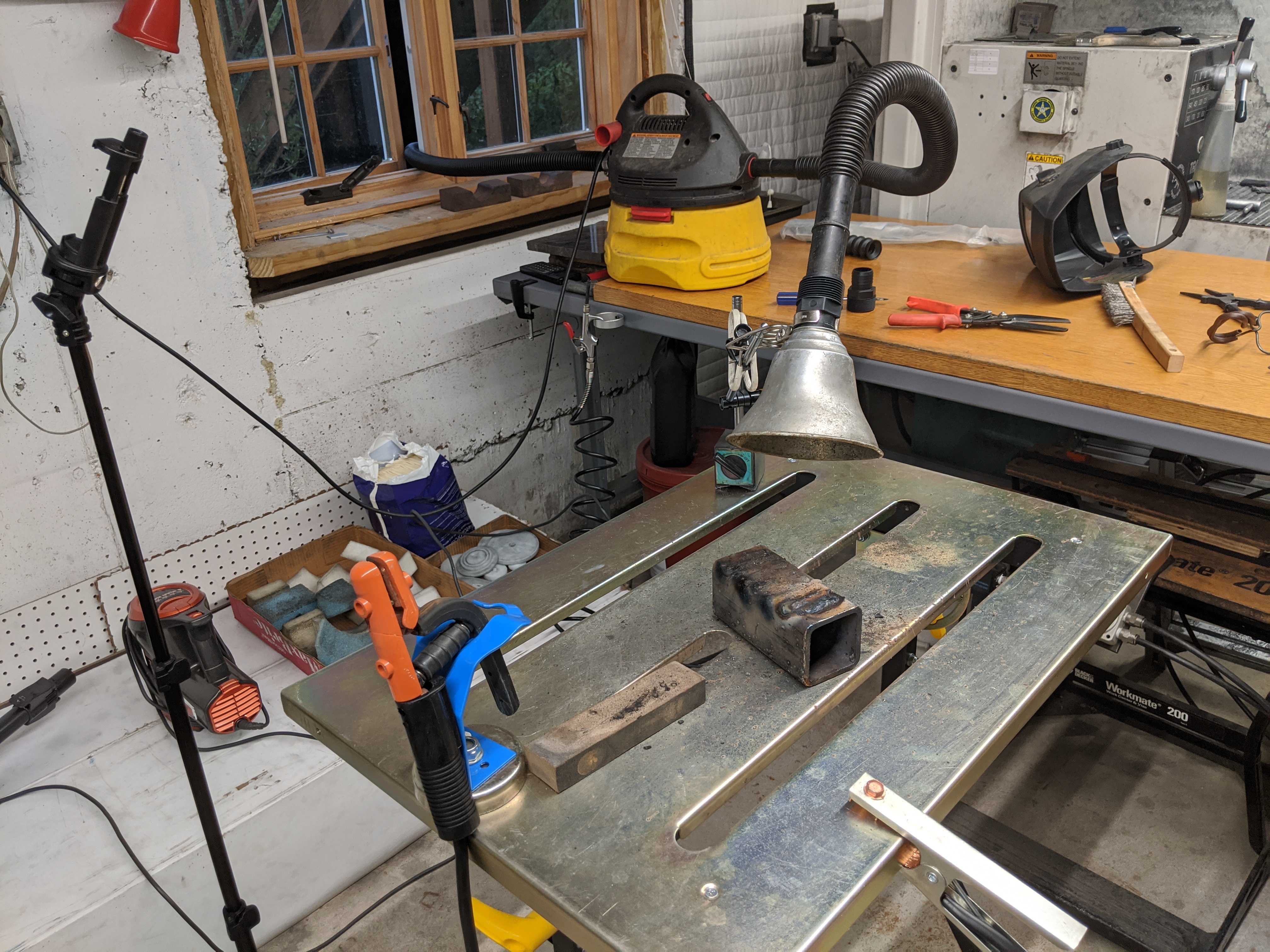

I wanted to weld in the garage because I could open the doors and also just blow all resulting dust and stuff out with a leaf blower. Not to mention I have a nice wide driveway to work on. In the shop though, it's fairly tight in there, and now I gotta also figure out a fume extractor system. I'm working on that btw, using an old vacuum cleaner, it's gonna be pretty crazy if it works (I'll make a post on TBN if it works out).

Here's me yesterday, playing with the vacuum fume extractor thingie I threw together real quick. It works ok, not great not terrible.
I'm thinking of using a flexible ductwork with a duct fan, anybody do that? I saw a dude on youtube build one for his motorcycle exhaust. I just don't know if a duct fan would be powerful enough to suck up the fumes with the open duct hovering over the welding table.

Gene, Looks like your little welding space is working for you.
Only guessing for your "vacuum fume extractor thingie", but I've heard that those Kirby Vacuum Cleaners do everything, especially sucking, ha.
Ya might look at HF for a 8" - ?" diameter exhaust fan, maybe about $50-$80?
Just a thought from your pic, looks like you might be getting some arcing from your weld material to your welding table because of all those little "dingle berries" (weld splatter) stuck to your table?
To correct that condition, if it were me, I'd grind the table surface smooth with maybe a 60-80 grit sanding disc, and/or clamp your weld material to the table/clamp your ground clamp to your weld material.
It looks like a fun learning curve for you.

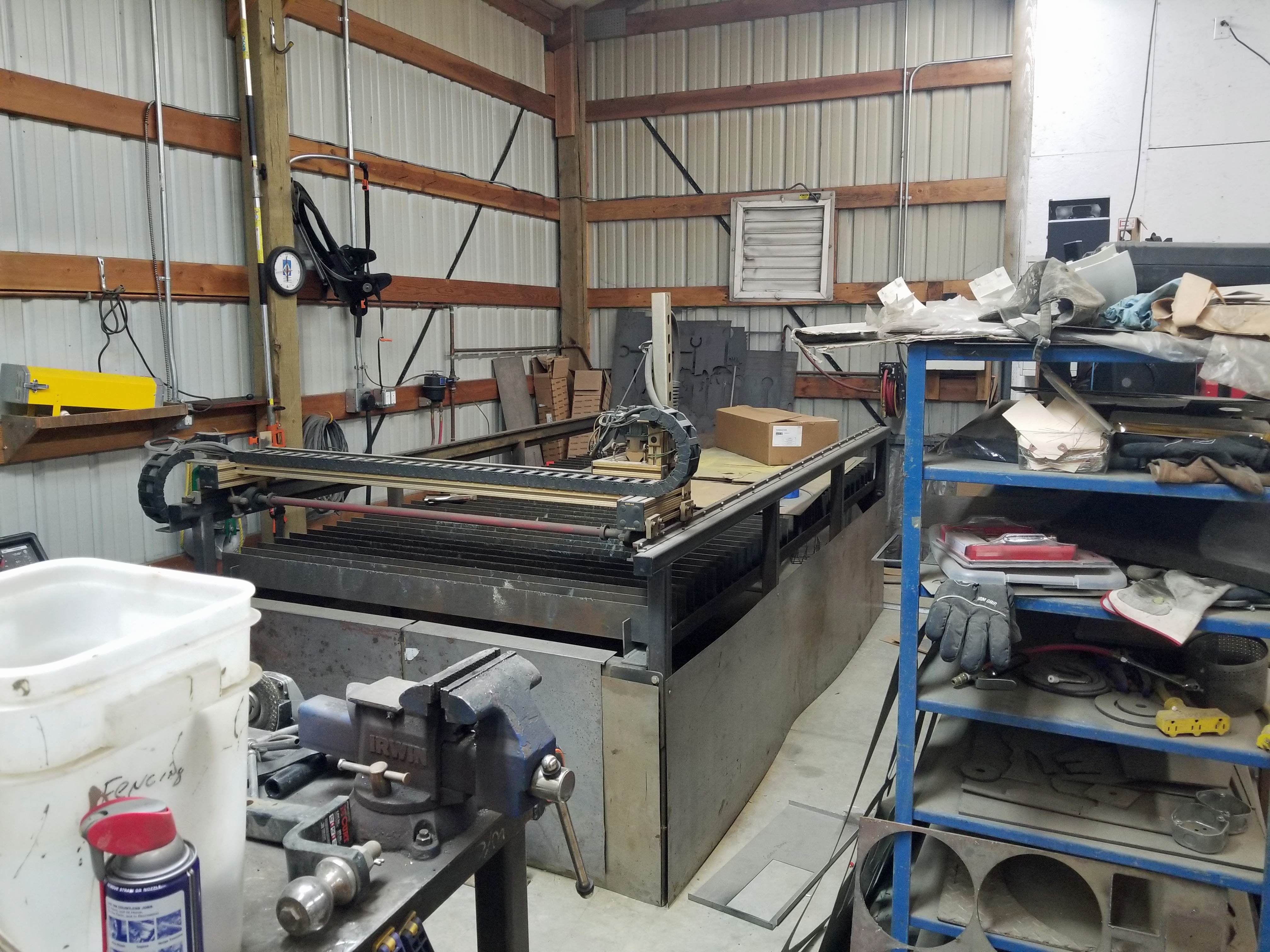

im wondering if all you need is a large box fan in window to draw out the smoke. i had to go with a high flow wall unit due to my plasma table. it does suck everything out. especially all the heat in the shop in the winter if i use it. makes a nice warm shop like a refrigerator in a few minutes.shop 2020-4.jpg. the exhaust fan is the large rectangular item on wall at end of table. Vent closes when fan is off. its a 240 volt unit. moves a heck of alot of air....and dang noisy.

I'm having a blast KC, that's for sure. I'm getting arcing mostly from the electrode sticking when I start welding. While prying it off, I got the metal flopping all over the table, getting all sparkly and stuff lol. Good tip about clamping it down, and I will grind the table a little, surface is getting a little rough, yeh.

im wondering if all you need is a large box fan in window to draw out the smoke. i had to go with a high flow wall unit due to my plasma table. it does suck everything out. especially all the heat in the shop in the winter if i use it. makes a nice warm shop like a refrigerator in a few minutes.View attachment 669528. the exhaust fan is the large rectangular item on wall at end of table. Vent closes when fan is off. its a 240 volt unit. moves a heck of alot of air....and dang noisy.
Yeh, the winter is what I'm preparing for, I need to keep the place warm. All I got is electric space heaters in there, pricey running them as is when everything is closed off. That's why I'm trying to balance adequate cfm movement to get the fumes out without overdoing it and sucking out all my heat...as well as my air lol. I like breathing air. :D
