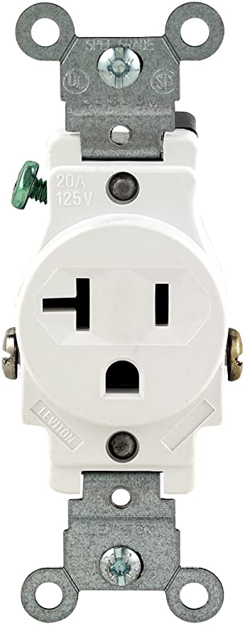

Until a few years ago it was totally fine to skip the refrigerator and garage freezer when assigning GFCI circuits. Normal people assumed no one is going to move a freezer out of the way to plug in sn extension cord and run a saw. They required us to put a single outlet there to prevent additional socket use. 46BCCAD6-8BF9-4DDA-A4E6-B3C935DE208A.jpeg. Then some idiot adopted a code to eliminate this. The nanny state at its worse. I cant remove them, but i tell other people feel free to remove the gfci if they value their food.

Until a few years ago it was totally fine to skip the refrigerator and garage freezer when assigning GFCI circuits. Normal people assumed no one is going to move a freezer out of the way to plug in sn extension cord and run a saw. They required us to put a single outlet there to prevent additional socket use. View attachment 676445. Then some idiot adopted a code to eliminate this. The nanny state at its worse. I cant remove them, but i tell other people feel free to remove the gfci if they value their food.
This is where my knowledge stopped... the last garage I did was exactly like this... single receptacle dedicated for freezer and same for opener on top of open rafter so 8'2" above finished floor... electrical signed off without issue and this also included a 30 amp 240 dryer.

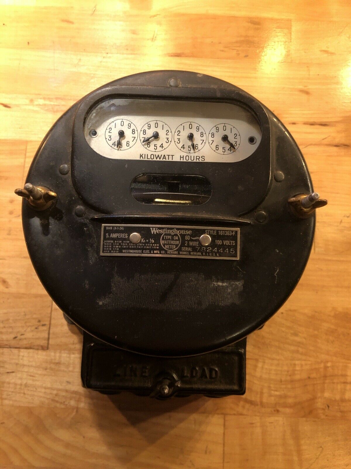

It felt eerily strange "Messing" with the service and just after I had jumped the meters PGE meter reader shows up on regular rounds and he says no Meters?... I say here they are... and hand them to him.
Original service was two 120v 30 amp fused main... so no popping the meter back in because they had brass wingnuts with tamper wire seal on cloth loom covered number 10 wire.

Wish I could have kept all these I pulled from service... just for conversation... 80+ years of faithful service... the replacements only lasted a few years pending smart meters.
I still have a few single family homes with two wire meters and 30 amp service... so no welders going in yet...
