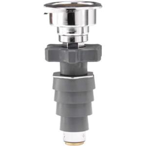

I wont recommend the cooling system combustion test on a diesel engine to anyone from this point on, gas yes diesel no.
Me either Esp.if it's Hot. If it's that Bad all the one's I've seen has a relief valve on the Gauge which tops at 200 PSI. and on the Cap so you can take it off ;)I thought I seen one also on the cheap. You can Just about make one Like this.

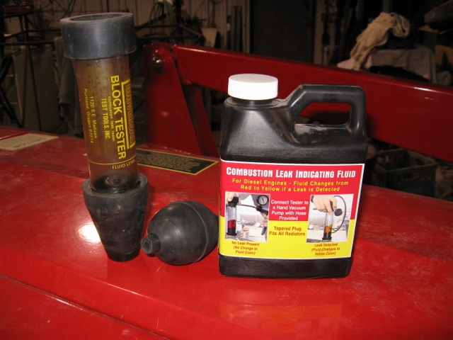

Here is what I was using carey that I don't like on diesels now.

Gotcha!! Kind of don't blame you there.:laughing:

Hey Carey just for grins I stuck that tester with the fluid in it right into my exhaust stack and had it bubbling with pure exhaust fumes and it still wouldn't change colors what a joke for a diagnostic tool its pitiful hahaha!
