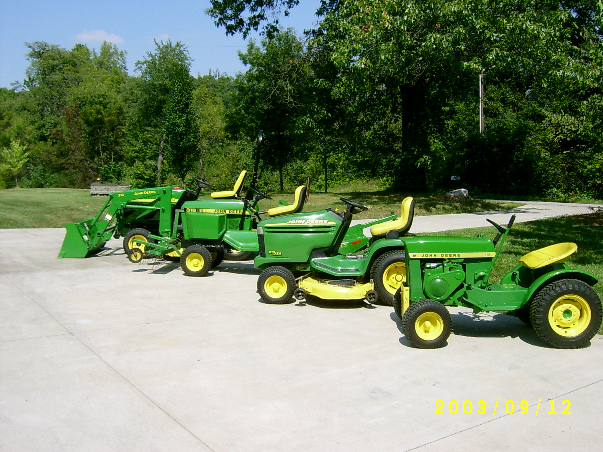

Lobo, I'm not comparing the quality of your TracVac to AgriFab, but rather suggesting there are alternatives to paying $2500, new price for a TracVac. No question, you have a great unit and I suspect anyone on this site following this discussion with a 2210 or similar unit wish they had one, self included, but not everyone wants to spend $2500 on a new unit. Like yourself and I suspect this would be true for many of the guys following this post, if a unit like that became available at the price you paid it would be resting with the rest of my toys.
FYI... you don't need to lecture me about the difference between department store equipment vs. commercial grade.
