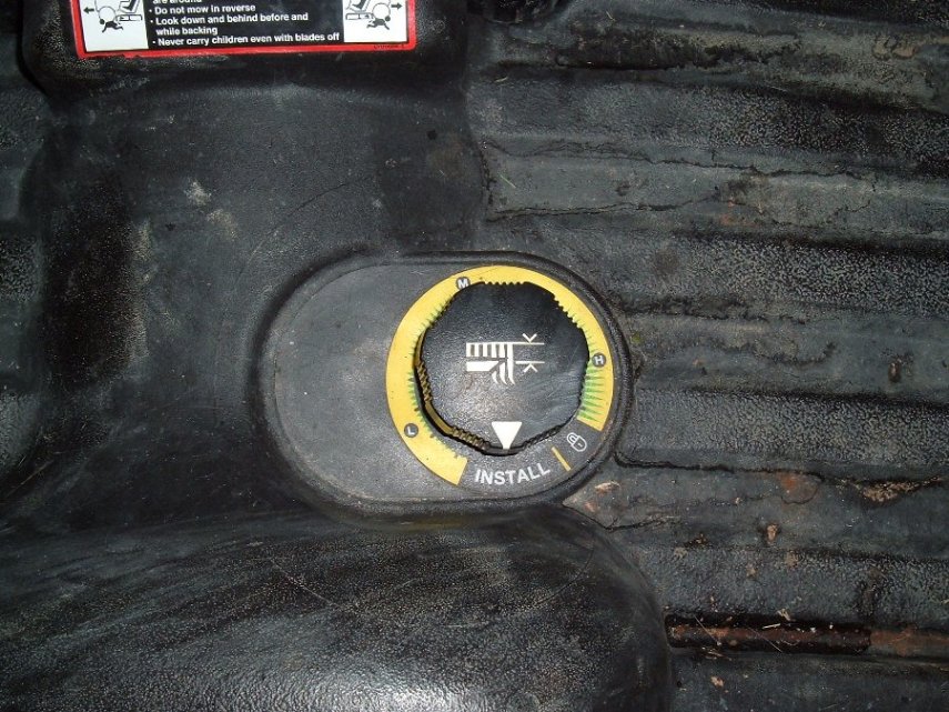

Hi all,
I have a 2305 with the 54C MMM. The decal for the control knob settings came loose, so now I have no idea where the 'Install', 'Lock', or inch positions are. How can John Deere get a reputation for a quality machine and screw up on nickle dime things like a flimsy decal; especially when a friend or neighbor is around when something like this happens, and hears me "make a comment" about what I think about John Deere trying to save money!?
Anyhow, I think I saw a picture somewhere of the underside of the height control knob and it explained where each position was; but I can't find it. I've gone through my manuals page by page, no luck. Does someone have such a picture or can direct me as to how to find out where the positions are on the height control knob, so that I can glue down the decal again and also use a permanent marker on the tractor deck to mark the positions?

On page 10 and again on page 18 of the manual, there is a picture showing the height control knob and decal. It's not real precise, but then again, neither is the knob settings.
   / 2305 control knob setting #4
Hope this helps.
