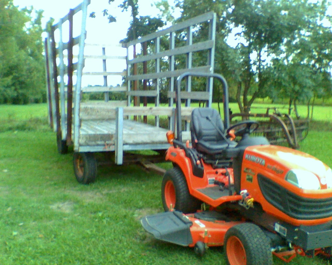

Today I had to park the haywagon and the big tractor (Kubota L3830) was on then other side of the field (about a 5 min walk from the house) so I hooked the haywagon (about 8x18 in size) to the BX2660 that we got a month or so ago to pull it down below (it is similar in size to your 2305).
It pulled it just fine, I was thinking of this thread, so I put it in 4wd, set the transmission to high range, brought the engine up to ~2800rpms and let her rip. Once I got it rolling good I let off off the hydro pedal and stomped on the brakes. It stopped in about 6 feet but left skidmarks the whole way from three of the four wheels. If there had been 1500# of people on board (10 150# people, not much when you think of it) I probably would have kept sliding for 15 or 20 feet. This was on flat ground next to the front hayfield.
Picture of the rig parked:
Aaron Z
I stomped on the brakes. :)
The BX don't have Brakes per say.
