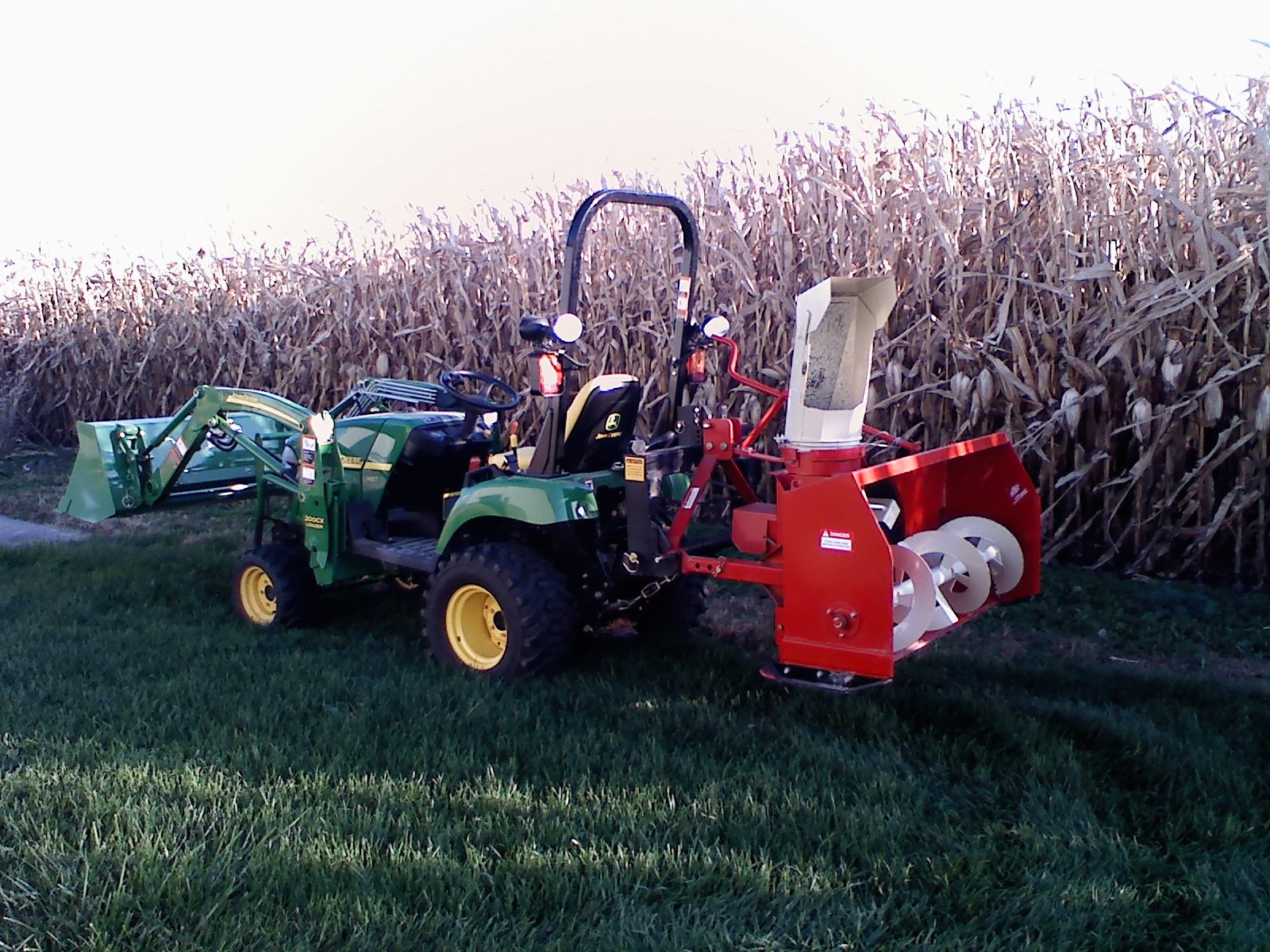

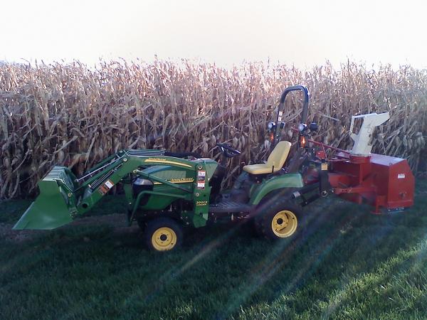

Ready for snow now!!! Buhler Farm King 50"
   / 2305 Snow removel #18
Looks like a nice set-up, it will make winter less painful for you. I have a 47" front mounted on my 2305, and got rid of the plow on the pickup.
I like your front and rear worklights, too.

I ordered two front light kits seemed more economical to me. I then used some flat stock and bolted both lights to it and on to the light guard. I ran with just three hooked up for a year and last week I finally hooked the forth up to try it. Needless to say I blew the fuse instantly so back to three it goes. I am thinking of adding the back two to a relay and run straight off a battery.
   / 2305 Snow removel #20
Warning:
The addition of a snowthrower may result in uncontrollable urge to add a cab and heater to your tractor.
And now yer out in the cold with the 2305.:eek:
Nice;looks like it did a nice job on that corn field.
