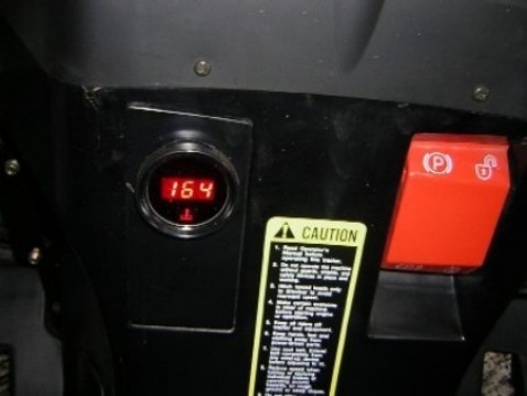

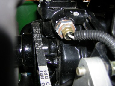

   / 2305 Temperature Gauge #7
One of the first mods on my 2210 when I bought it back in 2003 was the temp gauge. Still works fine..
Hey that's nice Labrat! Where did you get the gauge, and what did you do to get it plugged in on the sender side? Did you have to make and tap a hole?
   / 2305 Temperature Gauge #9
The gauge and sender is a cyberdyne from jc whitney. There was a plug in the thermostat housing that I drilled and tapped for the sender. It was on the the opposite side of the sender for the dash temp light. But mine has the 3TNE74 and the 2305 has a 3TNV76 so I don't know if it has the same plug.
Nice design, labrat! I just finished copying your install. Works great!
