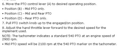

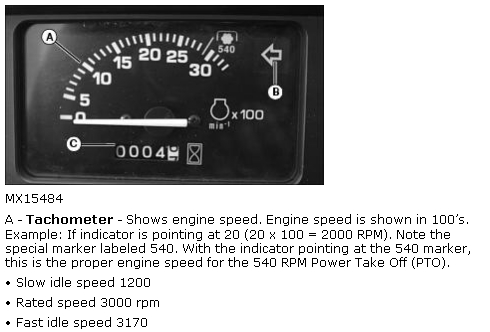

I agree with JCB this is a misreading of the manual. The standard rotation speed of the mid-PTO shaft is 2100 rpm. So at engine speed of 2900 rpm, the rear PTO shaft is turning 540 rpm and the mid/front PTO shaft is turning 2100 rpm. That is a standard speed for Deere mid-PTO shaft.
From the manual:
NOTE: The tachometer indicates a standard 540 PTO at an engine speed of 2900 rpm.
Mid PTO speed will be 2100 rpm at the 540 PTO marker on the tachometer.

The only place PTO speed is mentioned is where it states the PTO shaft speed is 2100 rpm, not the engine speed. When the engine speed is 2900 rpm you can run mid, rear, or both at the same time and both will have their correct speed, 2100 mid and 540 rear. There are implement combinations where you want to run both. That's why the PTO speeds of 2100 mid and 540 rear are standards.
