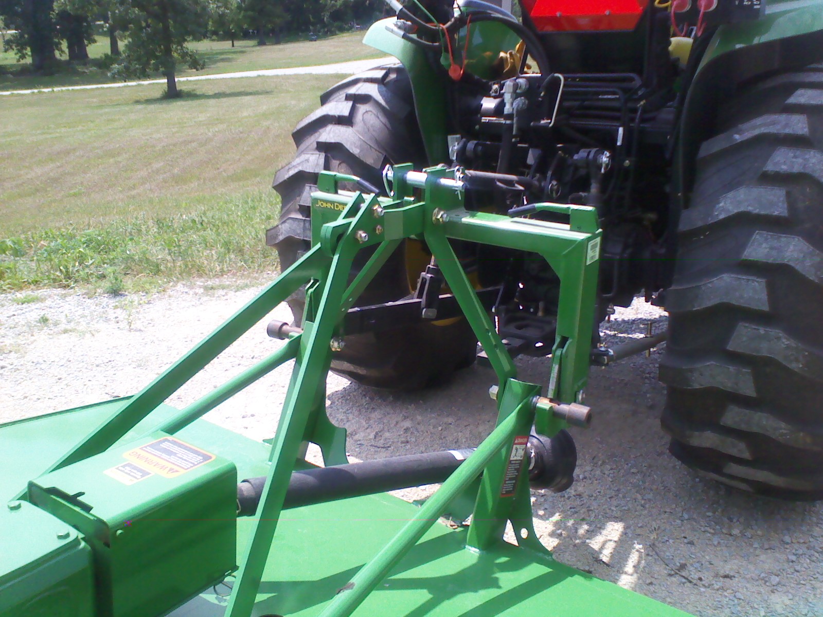

Well I went and did it, I managed to tear my rotator cuff and the bicep ligament holding the bicep to the elbow on the same arm so I will be one handed for quite a while. That makes changing attachments on the tractor really difficult. I use a brushog quite often so I ruled out the JD quick attach and Pat's Easy change after talking with my local JD dealer. Does anybody know of a company that makes adjustable bottom links for the three point hitch on a 2320? I am open to other ideas of course, the adjustable bottom links were all I could think of.

The dealer said that they (the quick attach systems) would not work because of the driveshaft legnth on my brushhog squealer and post hole digger.
/ 2320 adjustable 3 point links? #4
You should consider an extention for your pto stub if you need a few inches of extra length. Here is an example from Tractor Supply, Extension Adapter - 0271033 | Tractor Supply Company
An IMatch is a great addition to make hooking up your implements an easy task. Particularly with something as heavy as a brush cutter.

That looks like something that is doable and would probably work for me. I didn't even think of an extension. I sure wish this had happened to my left arm, man am I right handed.:cool: I would buy the extension just to get the connection point for the implement drive shaft out away from the tractor a few inches. You just leave the extension installed all the time correct? My understanding is that the Imatch requires bushings on the implements. Is this true? Also Kenny what advantages does the Imatch offer over Pat's or some of the other manufacturers? Thanks everybody for some very good information!

With the Pat's you still have to hook up the top link. With a quick hitch, you just hook the implement and latch it.
/ 2320 adjustable 3 point links? #9
Yes you need bushings for all three connection points. The advantage of the IMatch is it holds all three poiints fixed, you stay in the tractor seat and hook up. You have to make sure each implement is fitted correctly first but once done you are good to go. In my use with several implements it removes any reluctance to swap the implements as needed, only takes a minute or two to switch.

The iMatch is easy to install, but you couldn't do it with a bum shoulder without a helper. I'll attach a picture. I can post a better one tomorrow if you want. iMatch1.jpg
