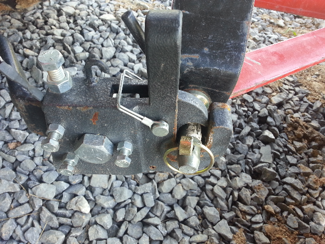

Here is a picture of the knock off of Pats Easy change. The real advantage it does give is the fact that it should fit all equipment and all you have to do is adjust your top link. But because of the extension, you may need a longer top link. My factory top link does work but it is almost adjusted all the way out.

The proper bushings are pinned on, so moving them is not a easy task. See the link I posted above.
