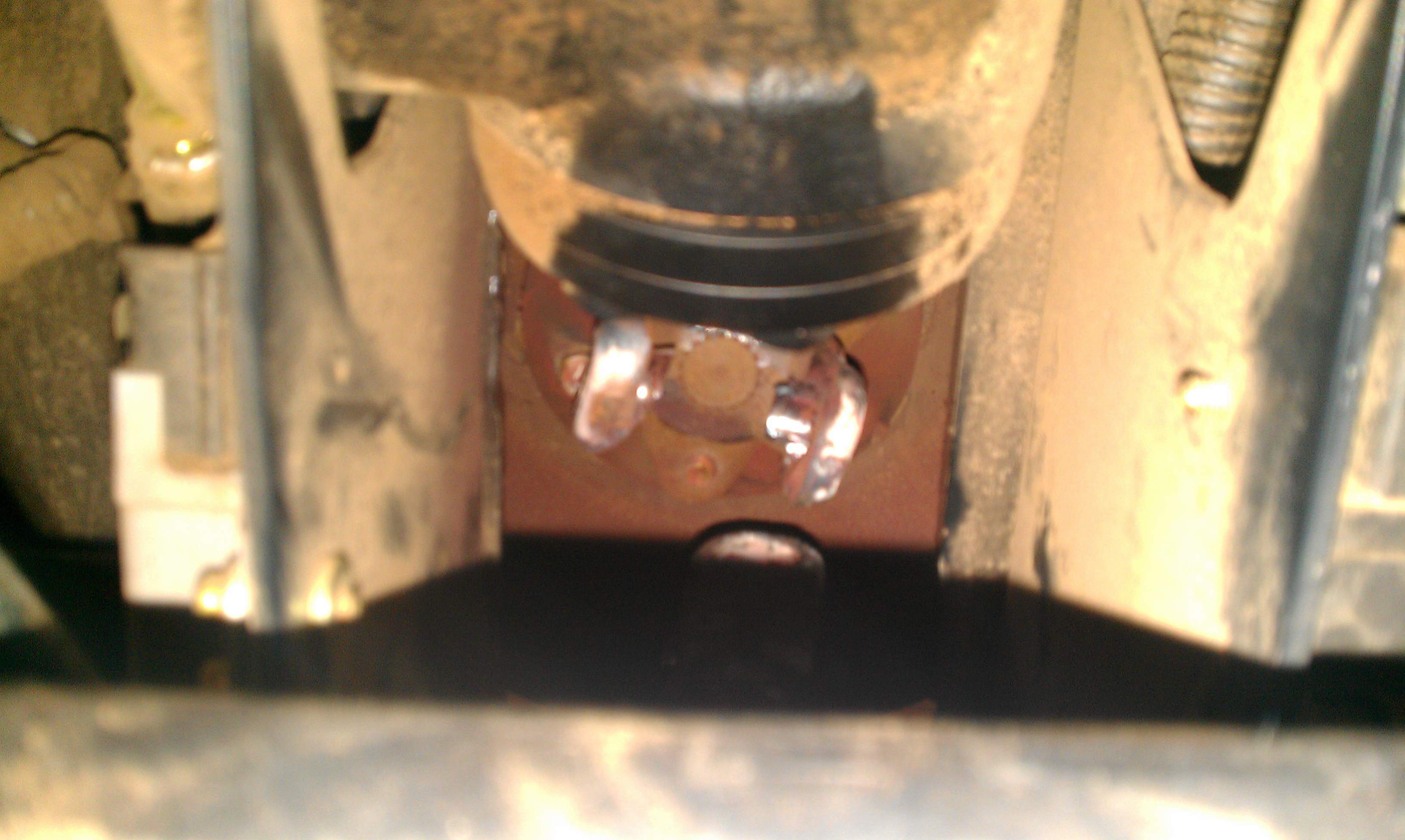

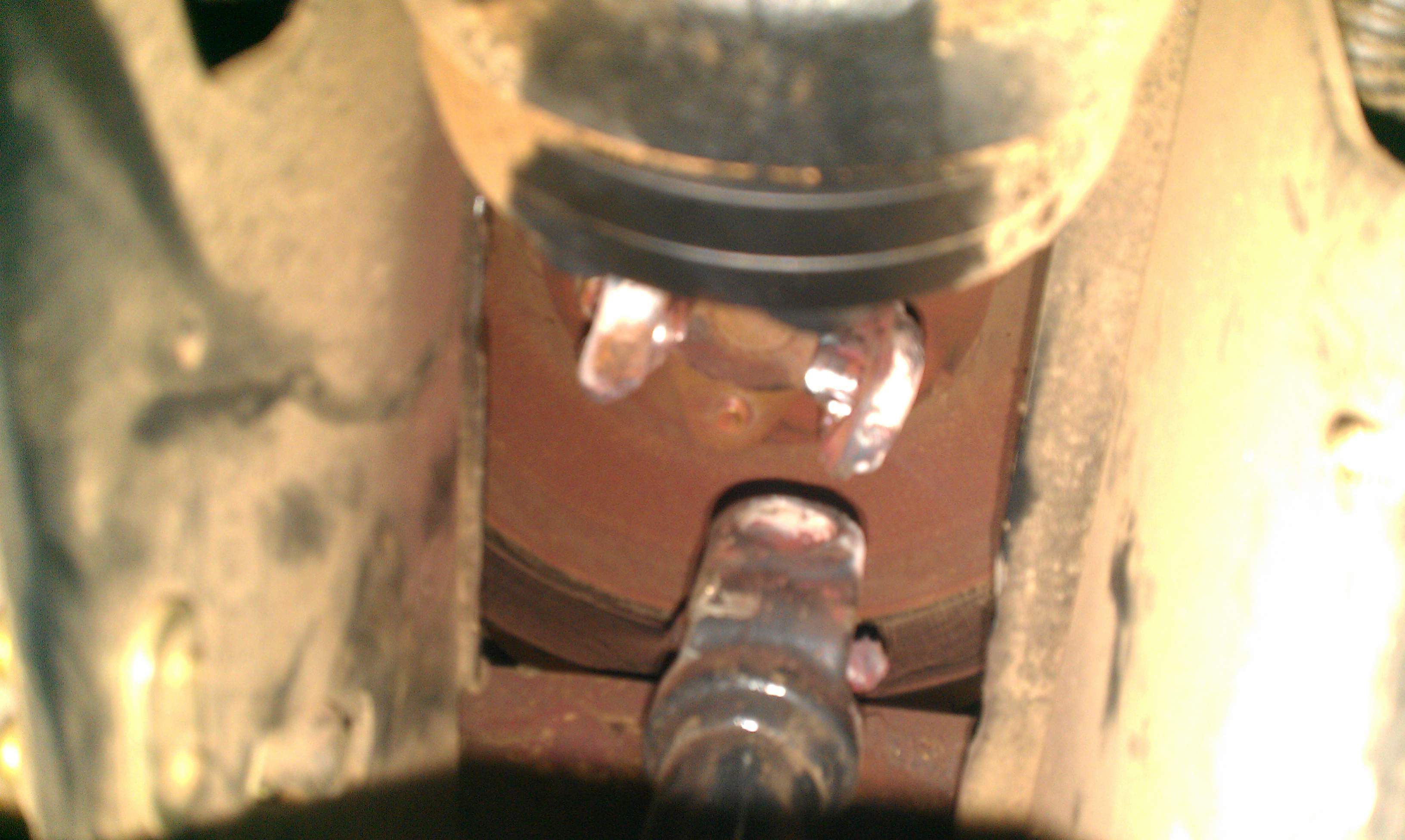

I was bush-hogging with my J D 2320 and the drift shaft dropped off. I thought it was a big clump of grass but because of the shape I realized it was my drive shaft clothed in grass. The u-joints are in tack on both ends. I assume it sheared off the rear spline. Is this a big job or fairly simple ? I have some mechanical experience but know some things are easier when you have the lifts and jacks... thanks for your thoughts.
   / 2320 Drive Shaft U Joint blew up. #104
Depends on which drive shaft it is. The lower one going from the transmission to the front axle is not all that hard, but if it is the top one...... I would not attempt. Just greasing the Zerk fittings on the U-Joints for that top one is hard enough.

Not sure of the hours, ill have to look. Not that many. I believe I have a 60" rear bush hog. I did not realize it has 2 driveshafts, I was wondering why the real wheel and PTO was both working, but not the front wheels. Makes sense. It is the lower drive shaft so hopefully it will be easy... THANKS!

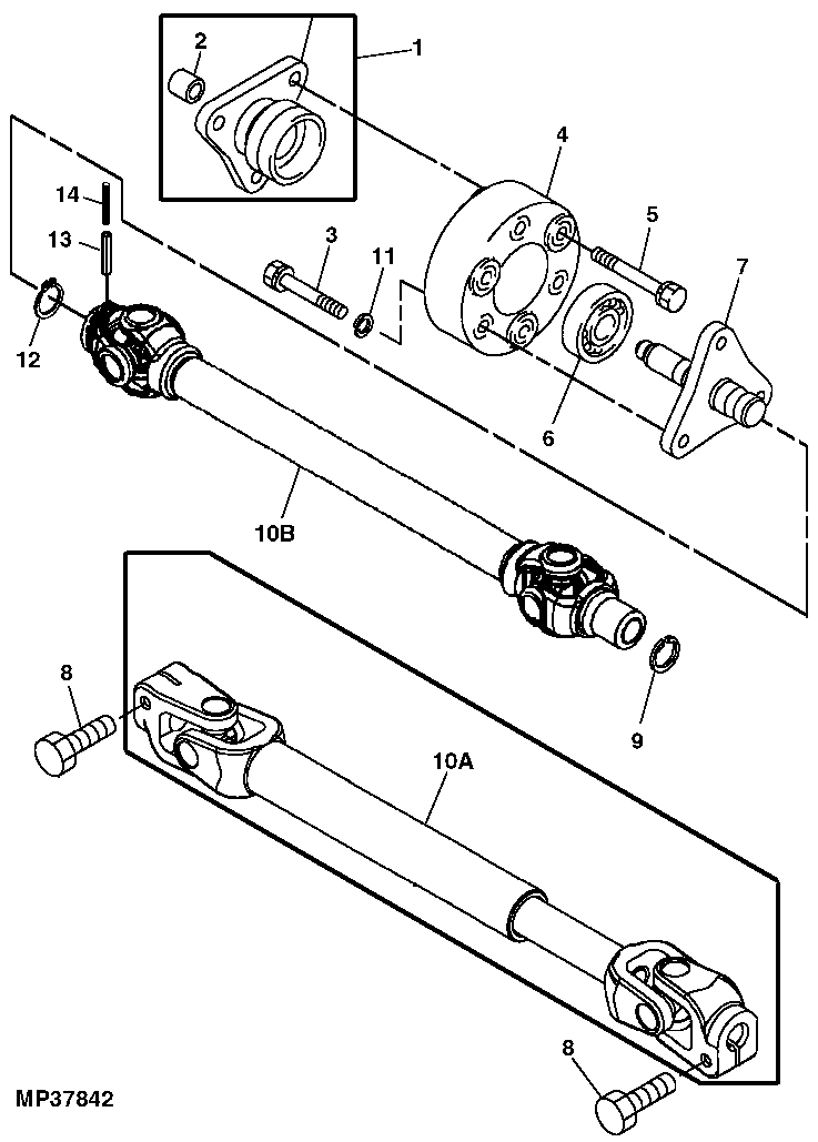

I have learned in life nothing is easy. :duh: It just looks that way until you start to fix something!
Here is a link showing a drawing of what lower or front drive shaft looks like. Maybe that front pin that is shown as part #5 and 6 broke?
