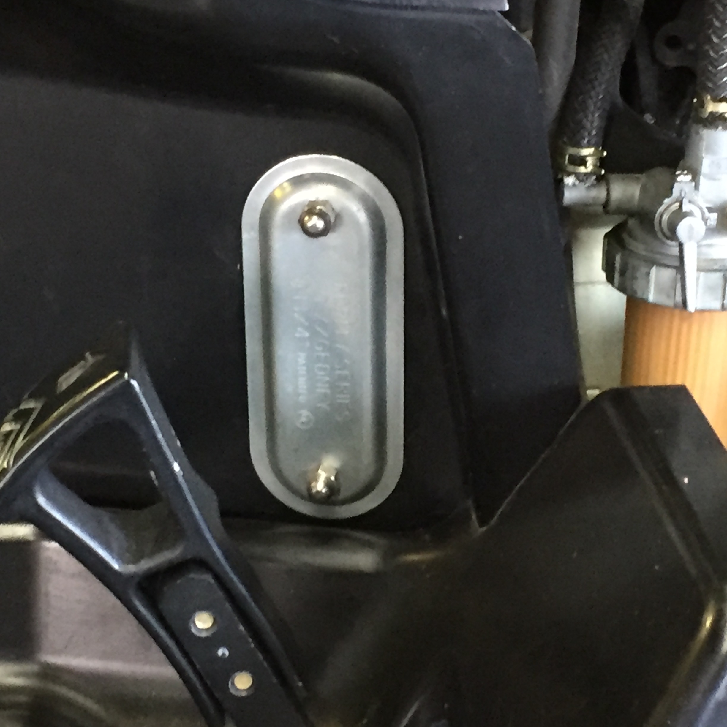

I had an issue also. Didn't know there were grease fittings on the driveshaft. The driveshaft that drives the front axle has sealed ujoint bearings. I looked but didn't see any fittings. After the front joint failed I took the tractor dash panels off to gain access to the access cover.
I didn't want to remove the panels every time i needed to grease that front u-joint. I figured the plastic would get brittle and crack over time.
I made an access cover to allow the inner access cover to be removed. I made up a grease gun extension using brass pipe. I put male and female grease gun fittings on the 1/4" pipe. I heated the pipe to make the required bend to enable me to get on the grease fitting squarely.
I purchased an electrical cover to use for my access cover. It won't rust and it looks good. IMG_2710.JPGIMG_2711.JPG
If you need pictures and measurements send me a message at (delrossa@hotmail.com).
I actually submitted this to John Deere but I am sure they won't respond.
Hope this helps someone.

Nice work but it's crazy that you had to do that. We pay a lot of money for these machines and they should be designed so grease fittings can be accessed relatively easily, or at least so owners don't have to create their own access panels.

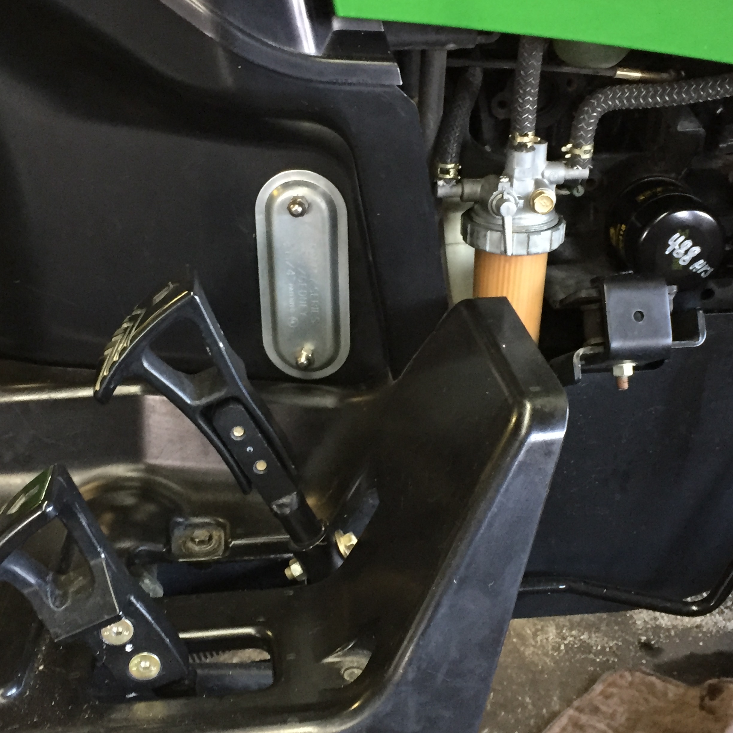

I purchased an electrical cover to use for my access cover. It won't rust and it looks good. View attachment 456681View attachment 456682
