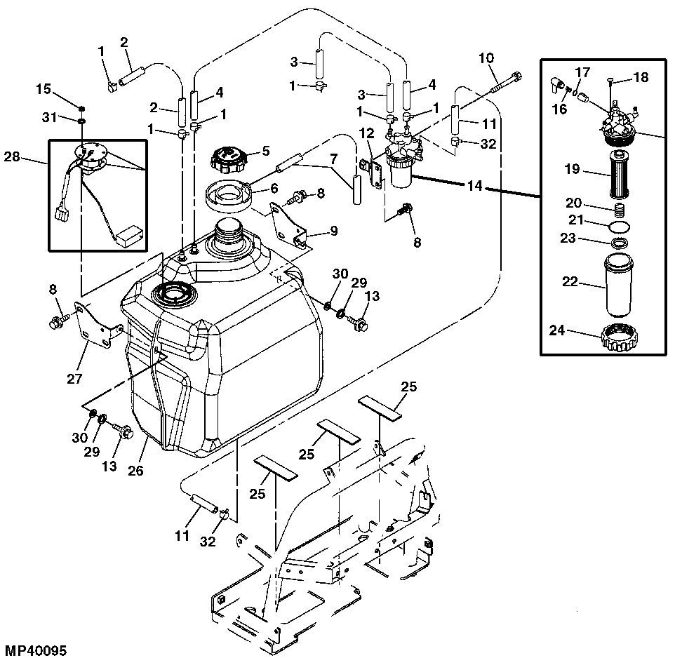

Beautiful day here in E TN. Trying to knock out a 50 hr service and the fuel filter came off before I was ready. A red washer/ring fell out as well as a spring. Where do they go?
/ 2320 Fuel Filter..Help please #2
Red ring goes in the bottom of bowl along with the spring that pushes up on the filter element. Red ring is a water level indicator(that is if any water is present)

Thanks. I also found some pics on this site after the fact. 2320 50 hour service is almost complete.
