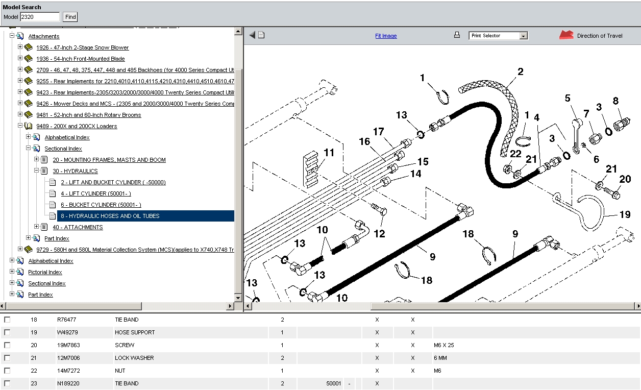

A neighbor has a J/D 2320 w/ FEL, 3 yrs old...
The question he raised to me, is there some bracket or modification that works for protecting the FEL hoses that are under the floor pan to keep them from snagging while using in woods ect........
He wants me to fabricate and mount something for protection on his tractor......any pics would be extremely helpfull....
Thanx in Advance.......Bill

Mine has a hanging loop the front side of the floor pan. I have never had a problem.
   / 2320 Hoses Hanging #3
mine didn't come with the hoop but I made my own with a coat hanger and attached it with the screw in the floor board where it was suppose to be.
   / 2320 Hoses Hanging #4
Looks like he is missing items 19 through 22.

Here is a picture, this should be part number:
W49279 SUPPORT, HOSE ADD 18.15 USD
Will that work with 2720.....or do you think they make one for 2720?
   / 2320 Hoses Hanging #7
JD Parts refers to that same drawing and parts list for the 200X/CX when looking under the 2720. Since it is considered part of the loader you will have to look if your tractor has the mounting hole for the loop. If no hole then it is just considered an unused part in the loader kit for that model tractor. Not an unusual situation. However, if no hole is found I would add one to make it work. Hoses should not be allowed to hang too low.

Thanx Guys, You were Right-On....!!
That's exactly what he needs.....I knew I came to the right place.......:D
