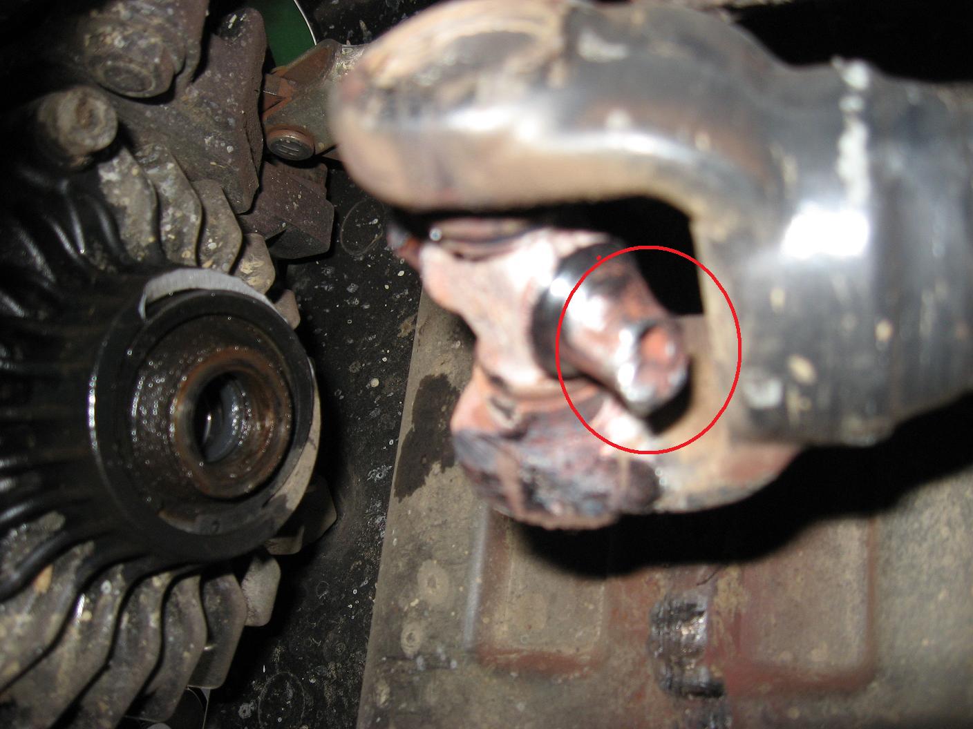

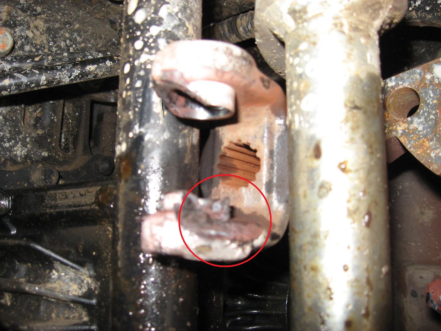

Doesn't this pic show the ear on the u-joint egged out from being worn out..??......looks like over some time......it would have been sloppy but connected.....
Maybe just the way I see the pic.....:eek:

Is this a fresh break or wear..??
Looked like wear to me.....
