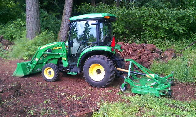

Okay, so I have had time to tell the whole story on this.. You might want to grab some popcorn.. Well, and maybe some tissues too.
I posted a topic about 2 months ago about my Drive line U-Joint blowing up, because it never got greased for over 300hrs.. One minor thing Deere forgot to list as a lube point in the manual, until recently. Well Deere did step up to the plate and cover the new shaft, even though it was out of warrenty.... And here the story starts....
I used the tractor for a few hours after it got the shaft repair, and I noticed that I was getting oil on top of the mower deck and on the shop floor. At first I thought it was just left over used oil that had got down in the frame when I changed the oil (Right after I got the tractor back.). However, there was too much of it and it was clear. I couldn't tell where it was coming from, so I had to pull the dash and the floor board off (For the second time.). I found the the steering valve was leaking around the bottom of the housing, but I couldn't tell exactly where. Knowing that the shaft had flopped around there, I wondered if the shaft had smacked it and cracked the housing...:( After ripping the whole dash apart I got the valve out, and didn't find any obvious damage. There is 7 bolts on the bottom cap, and I re-torqued them. 2-3 of them were loose. Hoping this was the problem, I put everything back together except for the dash. I went to start the tractor to test my work, but it would fire for about a second and that was it. I thought, oh I must have knocked a connector lose or got something wet when I was cleaning all the oil up. After trouble shooting it for 2 days, and called the dealer and told them to come and get it.:confused2:
And here we are, and I still haven't got an answer from the dealer. I also still don't know if my stearing valve is still leaking.

Talked to the dealer, and they pulled the pump of to send it in to get it rebuilt. So, 2320 injector pumps only last 330hrs?

So, I still don't have my tractor back, and its been in the shop for over a month....:mad::(
The dealer sent the pump in as instructed by Deere, and it check out okay. Which is not supprising since the tractor only has 330 hrs. The service manager told me that they think it has something to do with the timing, and that he had three Techs working on it. I've never done it but I have read the proceedure in the service manual, and it doesnt look that difficult. This was friday just afternoon, and he said he thought they almost had it. However I never did get a call back. He has been appologetic about it, but I still dont have my tractor. I mean come on, this is a certified Deere dealer and they can't fix their own equipment in a resonable amount of time... Their shop fee is $95 an hour, so you would think you would get what you pay for. I mentioned to him that if I didn't get it back soon I wanted a loaner. I'm trying to put a garden in for my wife, and she is not happy with the progress..
What should I do?... Its been on my mind to upgrade to the 3x20 series. Should I hit them up to make it right and give me a dealer invoice deal/or? on a new tractor?? Is that fair?

Stopped by the dealer today with my dad, because he needed an oil filter. Had a chat with the service manager, and they don't know what's wrong yet (Neither does Deere.). Their going to start tearing the motor apart next.

Well got a call from the service manager this evening, and it was not a happy conversation to say the lest. They started to tear down the motor and from what he told me the valves were gone. They also pulled one piston and the rings were stuck. The mechanic told him that he thinks that gas was dumped in it and wasn't lubing the top end.. There is NO WAY that put gas in the tractor! I have a Gal transfer tank that I fill from a local fuel company. I still question this thinking, but I'm not a diesel mechanic..:confused: At this point I don't know what to do, the tractor is out of warranty and the dealer is saying that I dumped gas in it. So there would be no way to push back on Deere.
I'm going in tomorrow to talk to the service manager, and take a look at the motor. I'm wondering since they have had it over a month, and multiplele people trying to trouble shoot it that they jacked it up some how.
