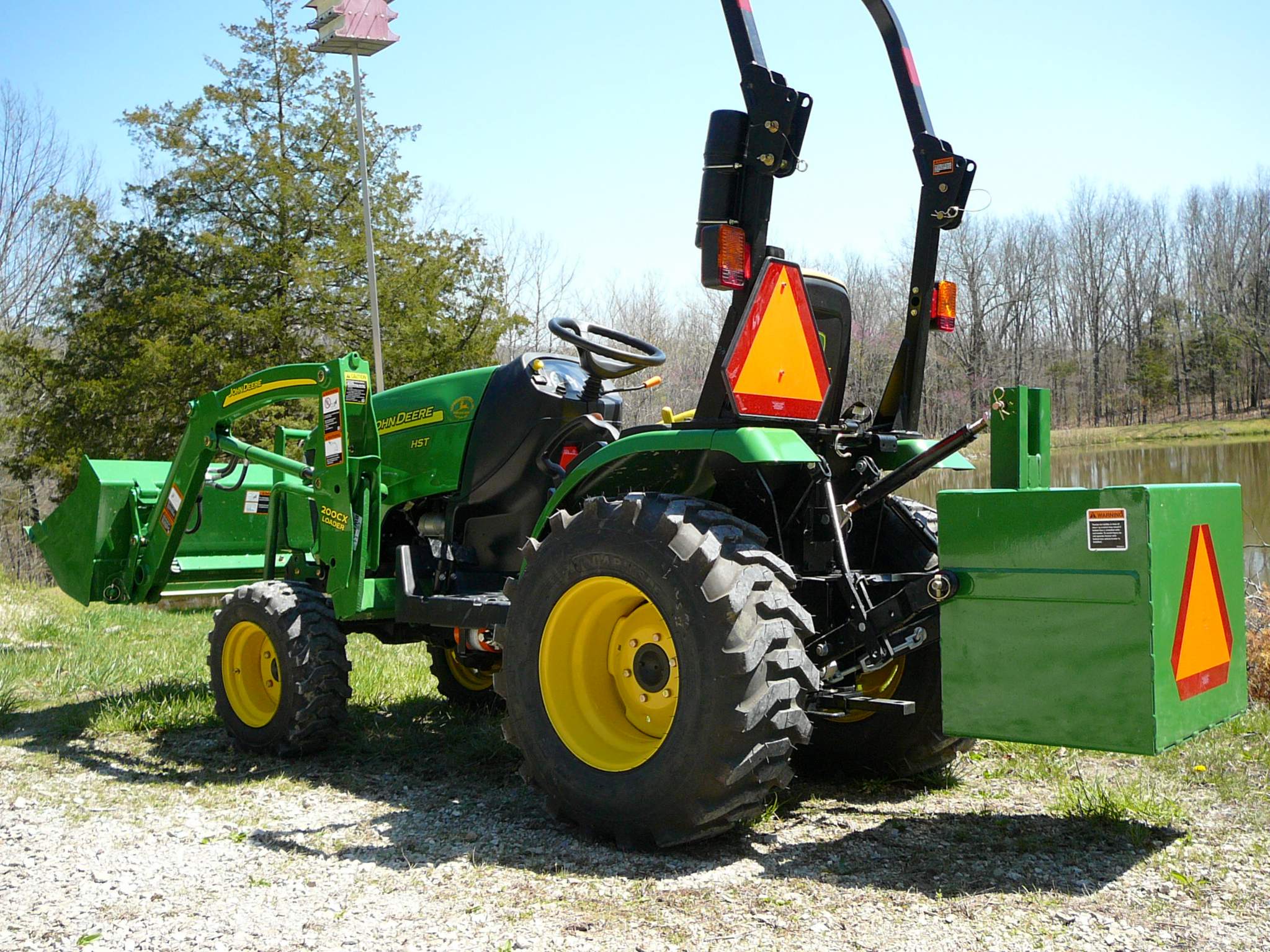

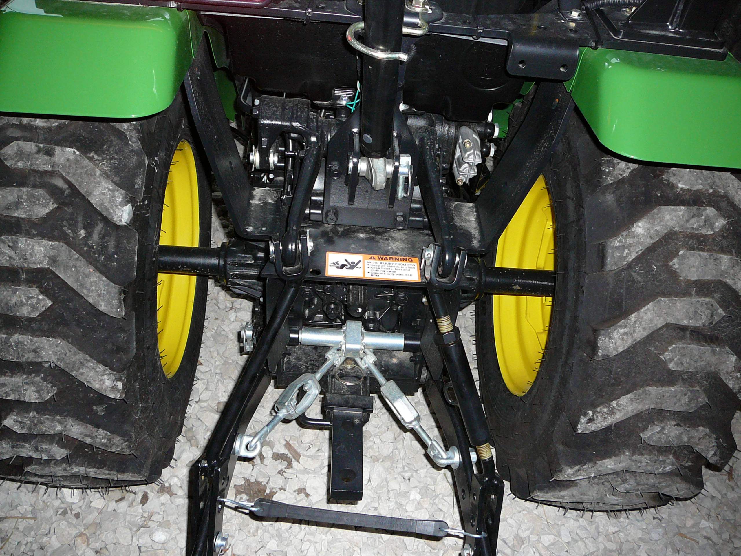

What a salesman I had !!! Tested both the 2320, 2520 at a rock pile in back of dealer. At first I was poking around at the pile,then the salesman come up and told me the ladies room is inside!! he cracked the throttle wide open and told me to attack the pile. He explained this was going to tell me the maximum these 2 machines would do. He explained that I could do as little and poke later on.
After the test of the 2320 and 2520 I tested a 2305 just to compare, What a mean machine the 2305 is!! Deere has their work cut out on the new 1xxx series. They better make sure there are no more new 2305 out there before the 1xxx finally hits the lots. A very productive machine the 2305 is, but no new ones here. Test drive of the 2520 loader no more at all over the 2320, when the 2320 said thats all we switched the same fully loaded bucket over to the 2520 (still full same weight) 2520 said "I GIVE" also no different in capacity.
I asked my salesman about the drive shaft on the 2320 vs the 2520, his reply was "you think your a better engineer than yanmar that builds these things"? he said with a smile. He then showed me the offset final drives on the 2520 and said, "you scared of a drive shaft? look at this setup compared to the 2320 big straight rear axles". (he said some freek out at the 2520 offset final drive)
Any way he knew I was approved to buy a 3320 (not what I need for my property) and told me it is all about working smarter not harder, buy what you want, not what your neighbor wants. I looked at my wife for advise and she pointed to the 2320 and said get this one its taller (than the 2520 hood) it looks neater!!!!
Go figure! I bought the taller 2320 over the 2520 took the $2000.00 I saved and bought the ballast box, 2 sets of rear deere factory wheel weights, tooth bar, rear 5 foot blade, and headed home.
